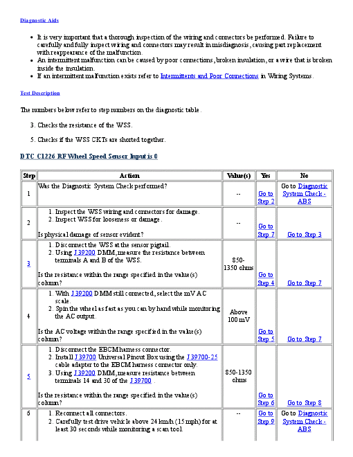

I know you had a new hub installed, but there is a test mentioned in the service manual to test it with a DMM and spinning the wheel. Might check that to be sure the hub is ok. Looks like it is intermittent. And the c1233 says there is an open/short in there somewhere. Sounds more like a hub issue or wiring. Check the wiring to that wheel from the hub to the connector on the EBCM. Info below shows which wires in the graphic. ABS wiring at the bottom of the page shows the connector to the EBCM. You can do the same test on pins 14 and 30 there to see how far upstream the problem is when spinning the wheel. If it works fine at the connector to the EBCM then the module could be the problem, otherwise, you can better follow the problem down to the wheel hub. These GIF images are tough to read so I added the PDF files as well.
File Type: pdf
File Type: pdf
File Type: pdf
