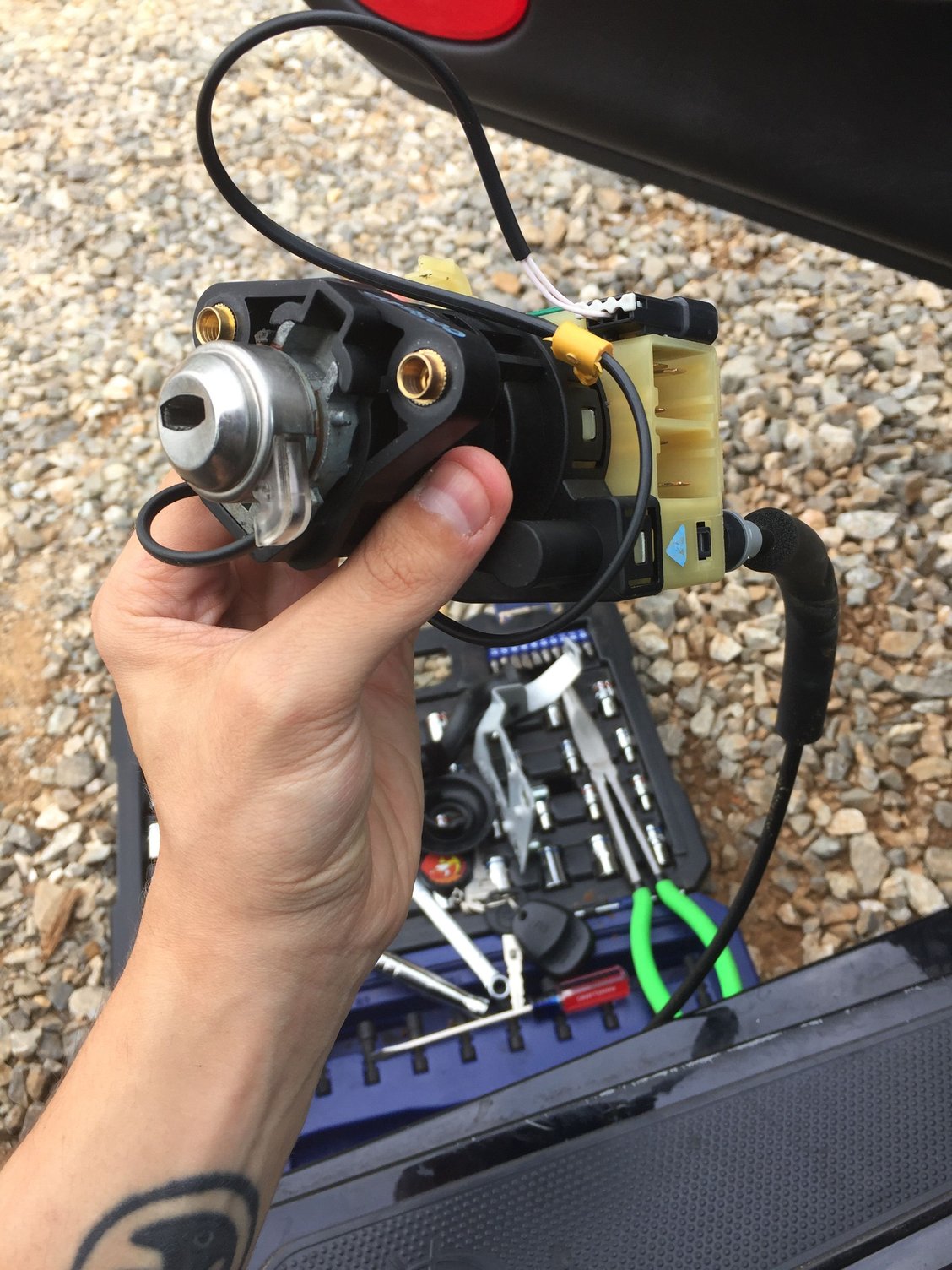

I installed a new ignition in my 2002 C5 and I am currently using the three 10's method to program the new key to the car. Since I replaced the whole ignition, will I need to have a dealership do anything in order for my car to start normally?

bought a used ignition switch with cylinder and keys. Nothing else was changed. This is the old assembly that I replaced. I just finished performing the three 10's and the starter will try to start the engine, but to no avail.

yeah, the battery was disconnected for the removal/install. I went back out to the car to check the codes, then I checked the battery voltage. The voltage was at 10.9. I charged it and it started up perfectly. The key programming process took more of a toll on its charge than I anticipated. Thank you for your help

Im confused! Why don't you just insert the key into the old lock cylinder, turn it to the RUN/ON position, depress the tab on the side of the plastic lock cylinder housing and extract your OEM Cylinder. THEN,,,,,, Just insert it the OEM key cylinder set into the new switch assy. ZERO reprogramming required. The ONLY reason that you would need a reprogramming would be if you use a different Key Resistor set. Why in the world would anyone do that???

I have replaced the Ignition switch including the key cylinder (which needed REKEYING) and also later the rear electrical switch portion and never had to reprogram the BCM or anything else. The key you use must have the same value resister pellet and that's all you need to start it. I did rekey my ignition at the Chevy dealer for $30 which was way cheaper than any locksmith in the Washington DC area. The switch only "feels" the pellet in the VATS system. It does not change anything.
