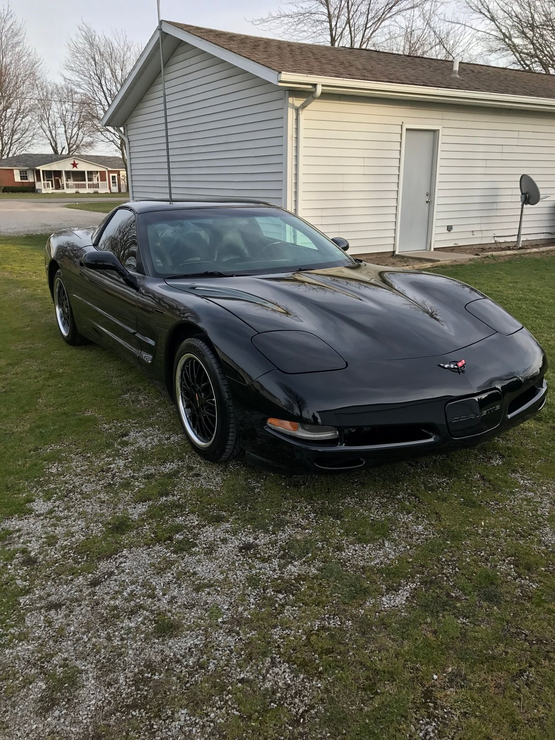

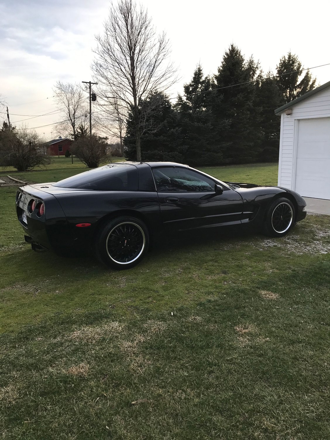

240 at times and that really worries me.. I'm considering a Dewitt radiator with the trans and oil cooler. Does anyone have any other brands they suggest and do you need to do the upgraded fans when you put in the Dewitt radiator? Or does anyone have any other suggestions on something to try to help my temps before I purchase a radiator? Im out of ideas.. seems like everything I read people say changing the puny stock radiator out helps them run about 30 degrees cooler. Thank you everyone! And what's a first post without pictures of your baby!😂

Great looking car.

The OP's picture shows trees without leaves and evergreens. In that climate I would probably not run the 160 deg therm.
