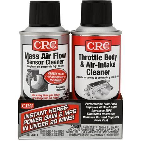

My base 04 had lagging and would bog a wee bit when I stomped on the pedal. Cleaned the MAF and Throttle body. Been like new ever since.
I used this stuff
