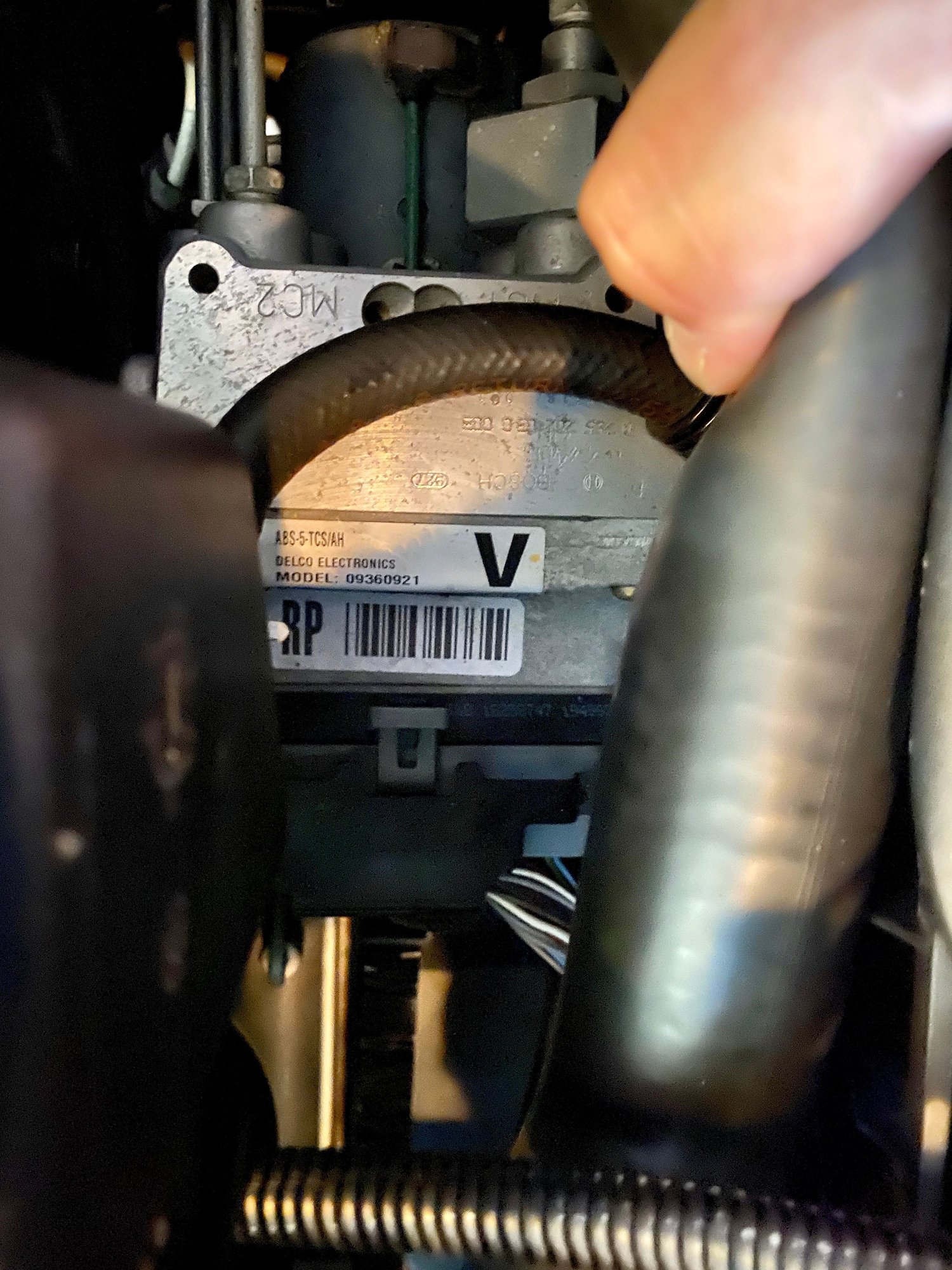

so after much debate on fixing the C 1243 stalled pump & Abs Traction control service light I decide to flush the brake fluid and see what happens, then the C 1217 code shows up and the shop
cannot find the electrical problem from code C1217 so I read this forum follow all the instructions on here and check the Abs 40 Amp Maxi Fuse and it’s blown! Buy a new one and the problem is solved! No more Abs Traction control Active Handling lights! Yeeepeee! Thanks to all u guys who put ideas into this Kudos to you all!

Have you checked the Maxi fuse 40 amps ABS? also read the post by pewter99 Admin. below was very helpful for me!

I had all but given up on my ABS/AH/TC on my 2000 vert. I exercised the pump for several times over a few hours, reassembled, cleared codes, removed window valet and the error codes persisted. Found this thread, and sure enough the 40 amp fuse was blown. Popped in a new one and I’m good to go. Took it out in the rain and commenced hard braking, donutting, and kicking out the rear end. Had a blast! And the ABS, AH, and TC kicked in as it should.
I’m super pumped! Drove around with those darn lights on for about a year.
