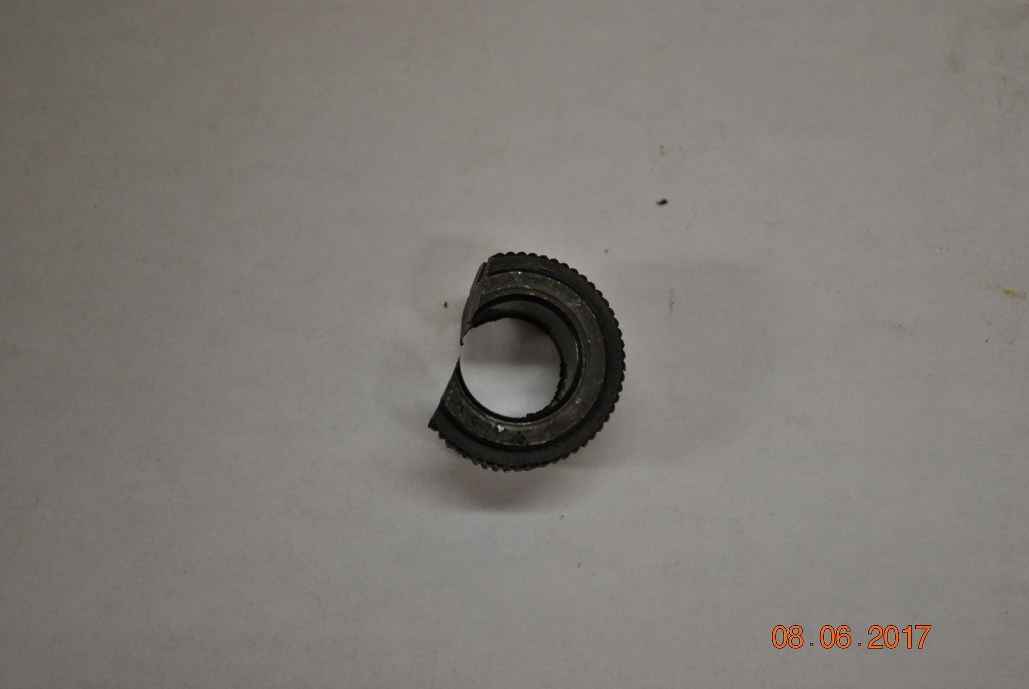

so i made a puller out of tool steel and got it done. i only managed to breake it loose after i put the bearing ball in there.
the m12 8.8 bolt was yielding, which means around 100 nm and 50 kn of force. i wanted to harden the "nut" and use a 12.9 bolt, but i can only get those with an allen head. no idea how that would have worked between the brake lines down there. so after three bolts and some high pressure lube:

well, the most frustrating experience was actually when i droped one of the halves and spent about an hour in total looking for it.
btw, i wonder how the new pulley will go on. if it needs 5 tons of pressure the 3/8 bolt wont like it.
