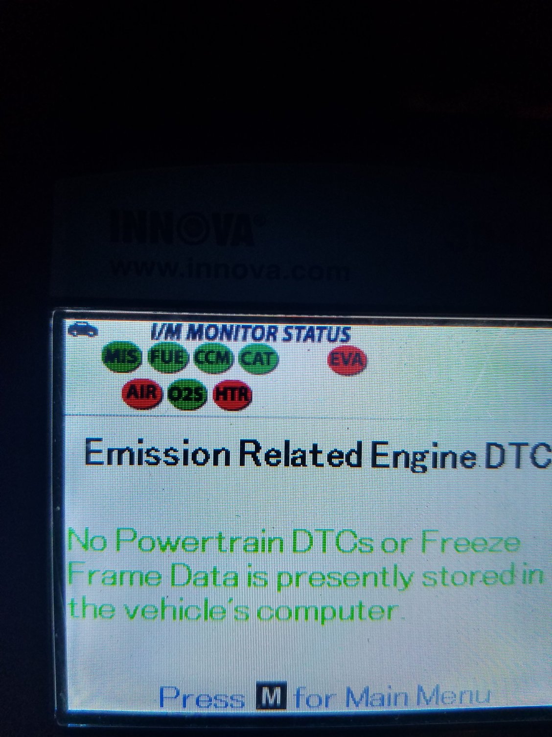

Old Sep 28, 2017 | 02:52 AM
wburner71's Avatar
wburner71
8th Gear
Joined: Feb 2017
Posts: 8
I also have these items listed in red. Not sure what they mean at all. No codes though
Old Sep 28, 2017 | 08:41 PM
Bill Curlee's Avatar
Bill Curlee
Joined: Dec 1999
Posts: 32,910
Likes: 2,402
From: Anthony TX
CI 6,7,8,9,11 Vet
St. Jude Donor '08
Do you have an owners manual for that scanner. Read it.
The EVAP means the emissions status for the fuel tank is not ready.
Not sure what the others in red mean without guessing
AIR could mean that the Air Injection Reaction (A.I.R. System) is not ready.
