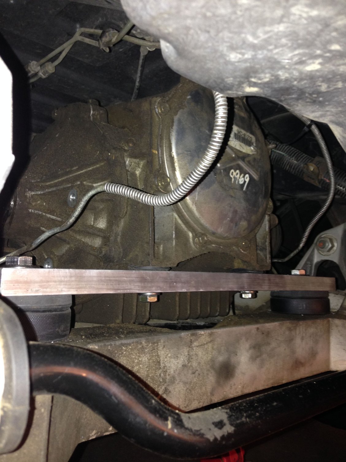

Waiting on my trans brace so I fabed up this gem. Hopefully it's a wheel hop eliminator and not multiplyer.

Did you drill the subframe for the bolts on the ends?
Depending on the grade of what I am assuming is a solid aluminum piece and the obviously aftermarket hardware used, I can see it working. However, the stock mounting holes would ideally be used. Drilling would only make the subframe weaker at those bolt holes.

I did make 2 holes in the sub frame. Hopefully it doesn't weaken it too much I guess.
NAH! Ide be more concerned about the diff bolts loosening over time due to the RUBBER washers betwen the bar and diff.
Dont know the durometer of the diff bar to K member rubber mounts but would be interested in hearing about how it works.
BC

Figured I would climb under and check the bolts every week. I used blue loctite also so hopefully it helps.

Interesting solution...curious how effective it is and if you have any issues with it. Is that a piece of aluminum bar stock that you used or is that another metal? If it works and does the job it certainly is much more cost effective than some of the other options. What did you use for the dampener going between the bar and the frame? It kinda looks like a hockey puck.
it is aluminum. My friend milled me a piece from work and got me fasteners. All I paid was $5 for some hockey pucks. Haha. I won't really know til spring cause I live in Minnesota but I think it will work and I only paid 5 bucks.

That mount looks pretty stiff. My only concern would be the motor mounts being softer.
The power-train and drive-line should move together as one unit or there could be stress on the torque tube.

I was thinking about that also. Not sure how firm hockey pucks are compared to motor mounts and such. Maybe I could get a couple more and make motor mounts too so front and back have the "same" dampening.
Hell yeah man...if it works and does what you want and need I think that is awesome. It may not be as 'pretty' as some of the other high cost ones offered but it's under the car and not 'on display'. I hope it works for ya.
As for the mentioned possible issue with the 'soft' engine mounts...maybe check into a set of poly motor mounts (Hinson comes to mind)? They will certainly be stiffer than the OEM ones are.
