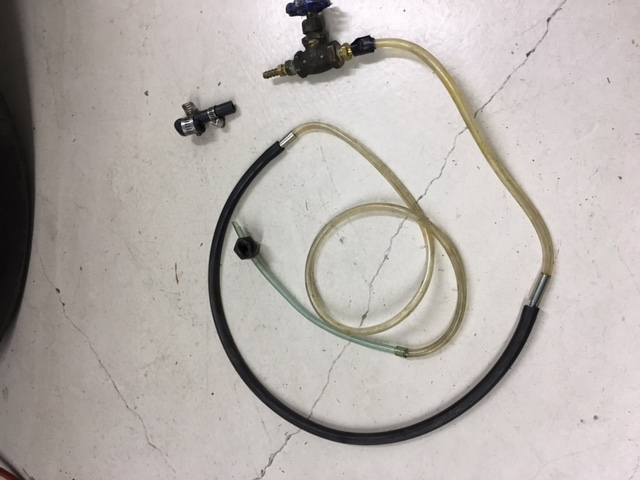

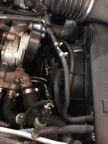

I think the radiator can have a lining of deposits in the tubes which will impede heat transfer yet still pass the test you performed.
Did you test the new thermostat in boiling water to make sure it opens fully? I never used to do that but do now. Ask me why.
You did not say whether the system pressures up-
If the coolant air bleed ports, tube or hose is blocked or partially blocked there could still be air in the heads. Being an '02, it only has the front ports connected, so it is important to confirm that the air is OUT. In my view, the only way to make sure the air bleed pipe and ports are open and the air is out is to vent the air bleed hose into a container on the garage floor with the engine running and system at pressure.
To do this, you need to cut the air bleed hose and put in a 1/4" barb- barb hose connector so that you can bleed the system into a container on the floor and plug the hose end going into the radiator (temporarily). Below is a picture showing the barb- barb connector on my car:
Below is a picture of the cobbled up rig I use to bleed. The clear vinyl portions of the hose are so you can see the bubbles coming out:
The short piece with bent over end is to temporarily plug the hose going into the radiator while you bled the heads. I know it is all kind of half- assed, but it works:
The last time I bled the heads on my car, it took nearly a QUART of coolant coming out before the bubbles stopped. When you are done, reconnect the air bleed hose at the 1/4" barb- barb connector and pour the coolant in the container back into the surge tank.
Don't let the surge tank get too low before stopping and refilling!
