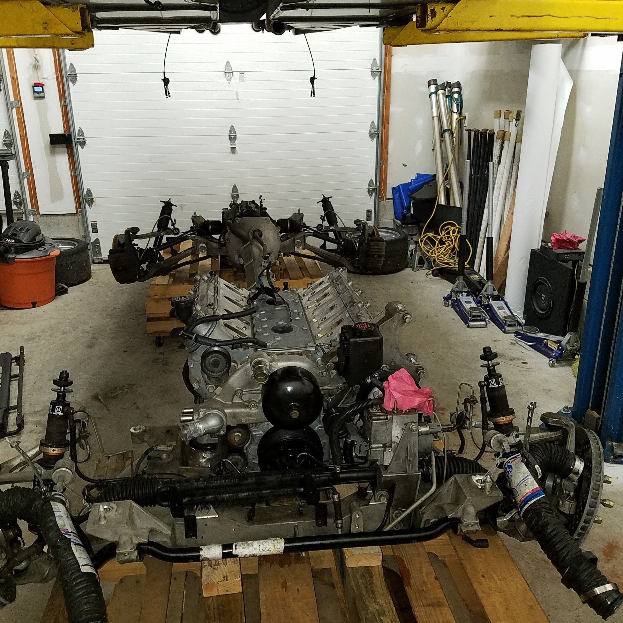

Update- Got the motor down, just have to lift the body up now and pull it out 🤙🏽

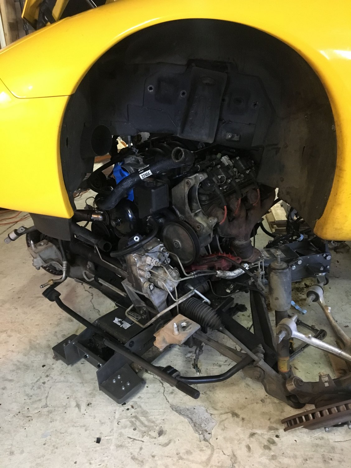

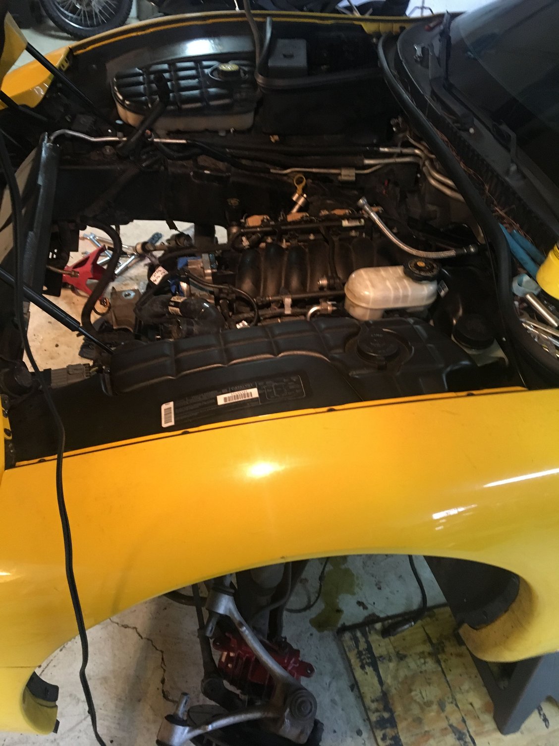

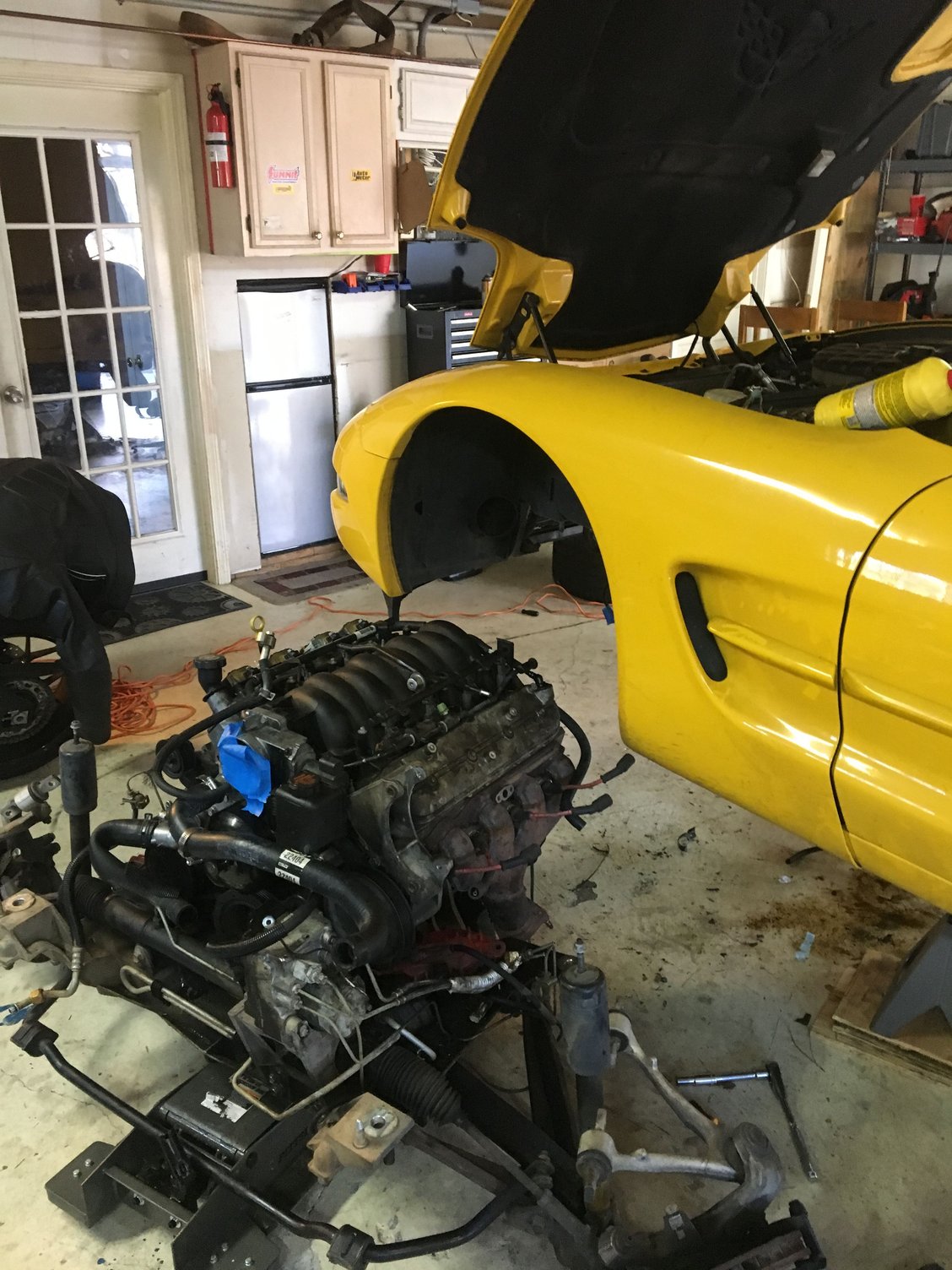

Been sick as hell but got around to pulling it the rest of the way out today. Just pulled it out from the drvers side wheel well.
