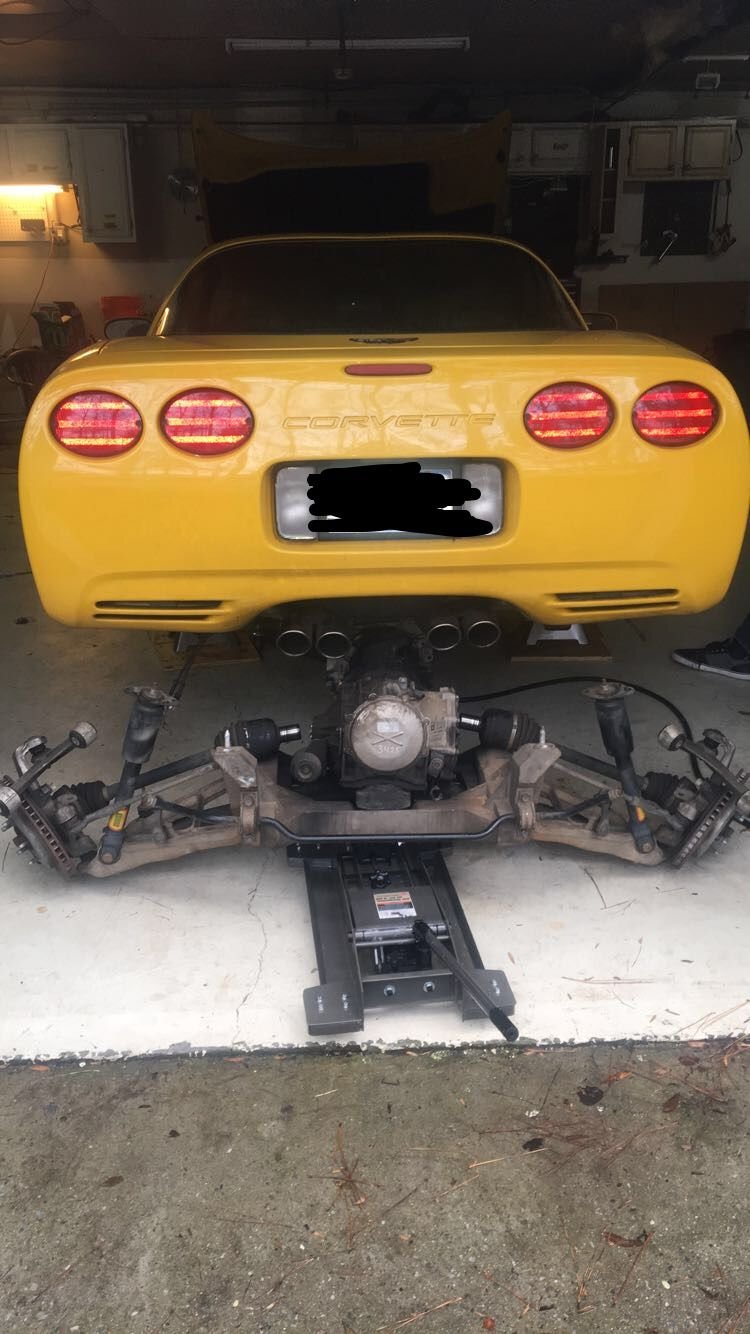

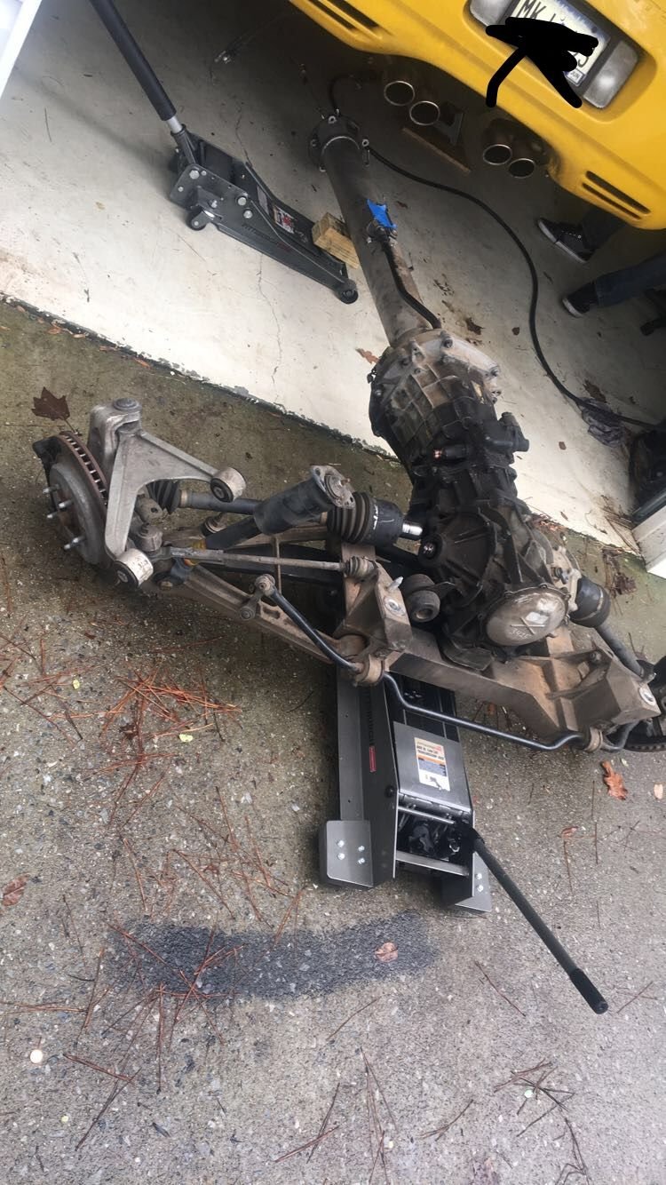

Made some progress on the vette. Wont start on the motor removal for a couple more weeks as im waiting for parts in the mail but so far so good. As you can see it definetley needs some attention.

DO NOT USE IMPACT TOOLS on the cradel bolts!!!!!!!!!!!!!!!!!!!!!!!!!!!!!!!!!!! !!!!!!!!!!!!!!!!!!!!!!!!!!!!!!!!!!!!!!!! !!!!!!!!!!!!!!!!!!!!!!!!!!!!!!!!!!!!!!!! !!!!!!!!!!!!!!!!!!!!!!
Only used it for the tunnel cover lol 👍🏼👍🏼
