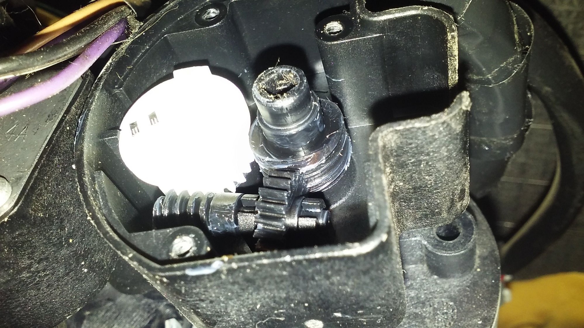

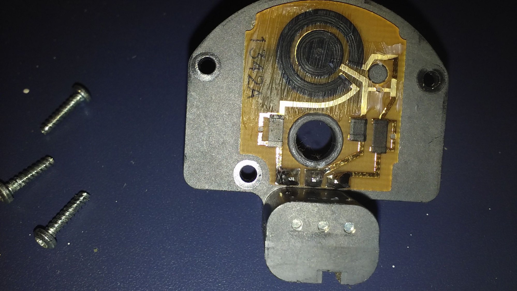

Old Jul 4, 2019 | 10:33 AM
TxFLSTC's Avatar
TxFLSTC
Joined: Sep 2015
Posts: 17
Default Great Fix
https://www.corvette-web-central.com...-problems.html
Same problem, so far fix is great !!! A few points:
Orientate so the lid is on top before opening or the parts will fall out. The white contact plate is slip connected to the white gear below such that it can re-center its travel if not put together just right. I cleaned with alcohol & added, with trepidation, small amount of silicon grease to contact circles on circuit board.
Bent up contacts very slightly. If you disconnect the position sensor wiring it will still hunt when 1st get into car after unlocking.
BGS 2000 C5 07/04/19
Old Jul 4, 2019 | 03:37 PM
GCG's Avatar
GCG
Joined: Jan 2009
Posts: 3,275
Likes: 739
From: Miami FL
Great tips and invaluable pictures!
