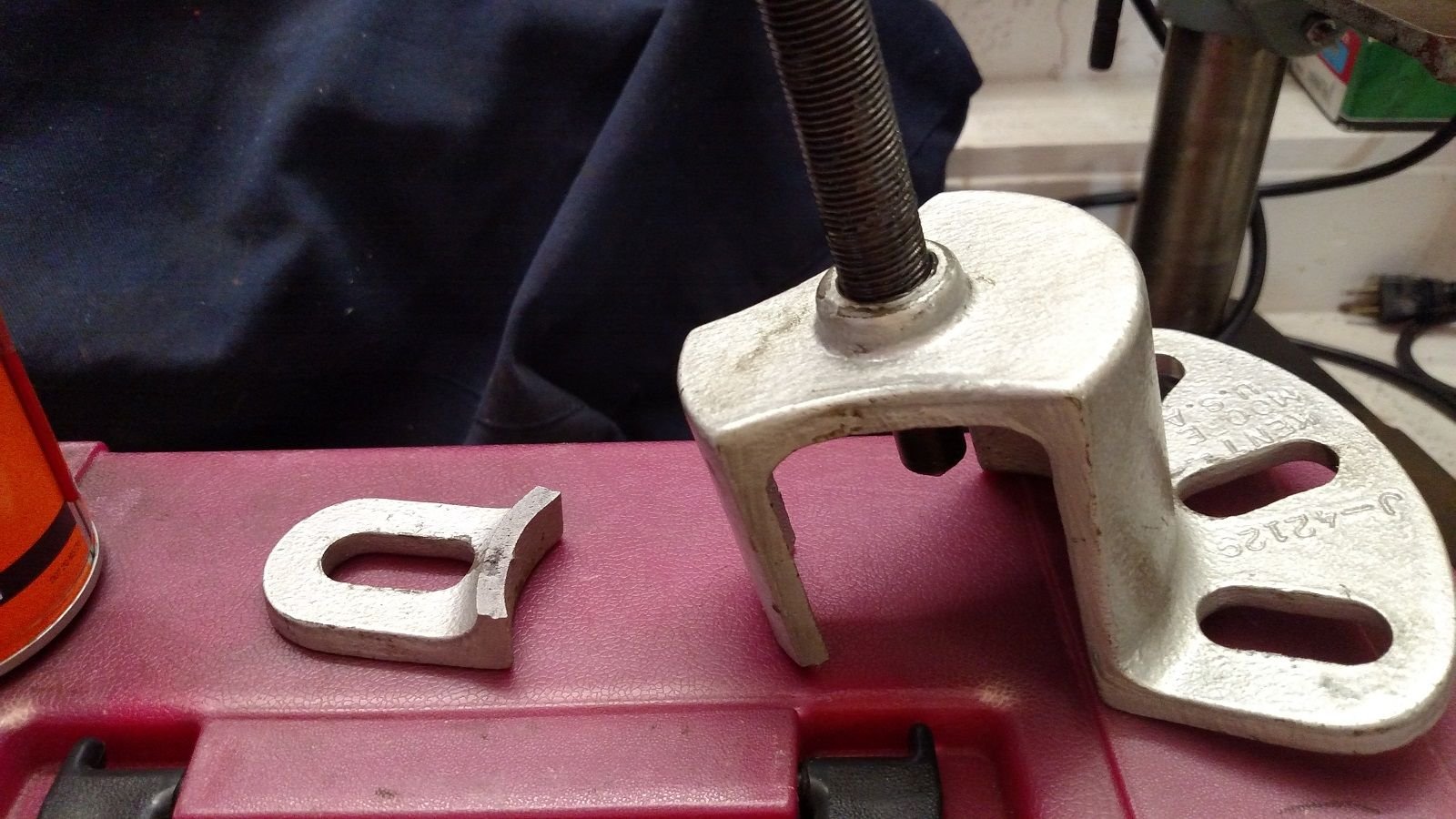

I have a leak in one of my CV boots. I am stuck trying to separate the axle from the hub. I bought an axle press but it will not do it, it just bends and deforms the lug nuts that are holding it on. Any suggestions?

While the puller/pusher was loaded I hammered on the bolt and nothing moved at all. I have talked to some local vette guys and they said theirs came right apart. I sprayed it with PB nut buster and put it back together, will try again in a few days.

So the weather has cooled in Florida so I decided to try this again. I took the nut off last March and filled the gap with Kroil, when I took the nut off today it was still in there. I put the tool J-4212S on the hub and started cranking, I heard a loud pop and thought it had moved, nope.
Any more suggestions?

I would have to heat the hub bearing assy, don't really want to do that. Yet. I suppose I could try taking the axle and hub out as a unit and try to get it into a press. But lots of fragile aluminum to worry about doing that.
