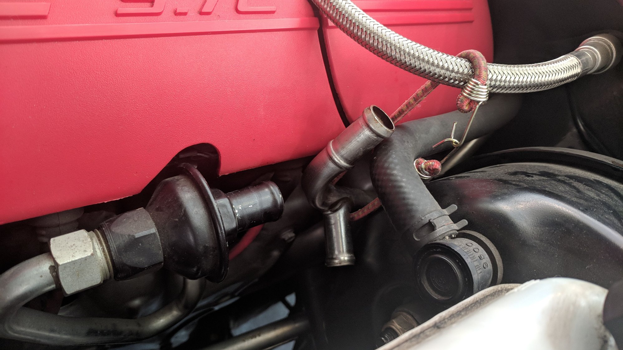

I finally got around to doing this... I took off the hoses from the driver side T. Plugged the bottom of the t with paper towel, shot pb blaster down into the aluminum t, and then compressed air.
I put it back together and the car is smoking a little on passenger side exhaust..? Is it ok or should I not start the car for a while? Kind of looks like a mixture of a lot of water vapor and a slight hue of black smoke. I'm assuming it's the residual on blaster burning off?
What is downstream from the passenger check valve? Could I have hurt anything? Does the residual pb blaster hurt the cats?
When I was shooting the compressed air it did seem to change sound as if the check valve became unstuck or something

What's interesting is after doing the PB plaster method down the pipe to the check valve, it seems like a lot of water vapor was coming out of the passenger side exhaust. Why would there be so much water vapor? Is it because the valve has been stuck shut and now that it's unstuck, there was a lot of built up condensation behind it that had to clear out?
Here's a photo of how I had the tube before I squirted the PB blaster in it, followed by compressed air. I plugged the bottom hole of the T with wadded paper towel so the air would be directed down toward check valve

Its the passenger side valve and replacing the driver's side will not make the code go away. The right way to fix it is to remove the intake manifold and replace the valve. May as well replace the oil pressure sending unit while the intake is off as that is a high failure item as well.
