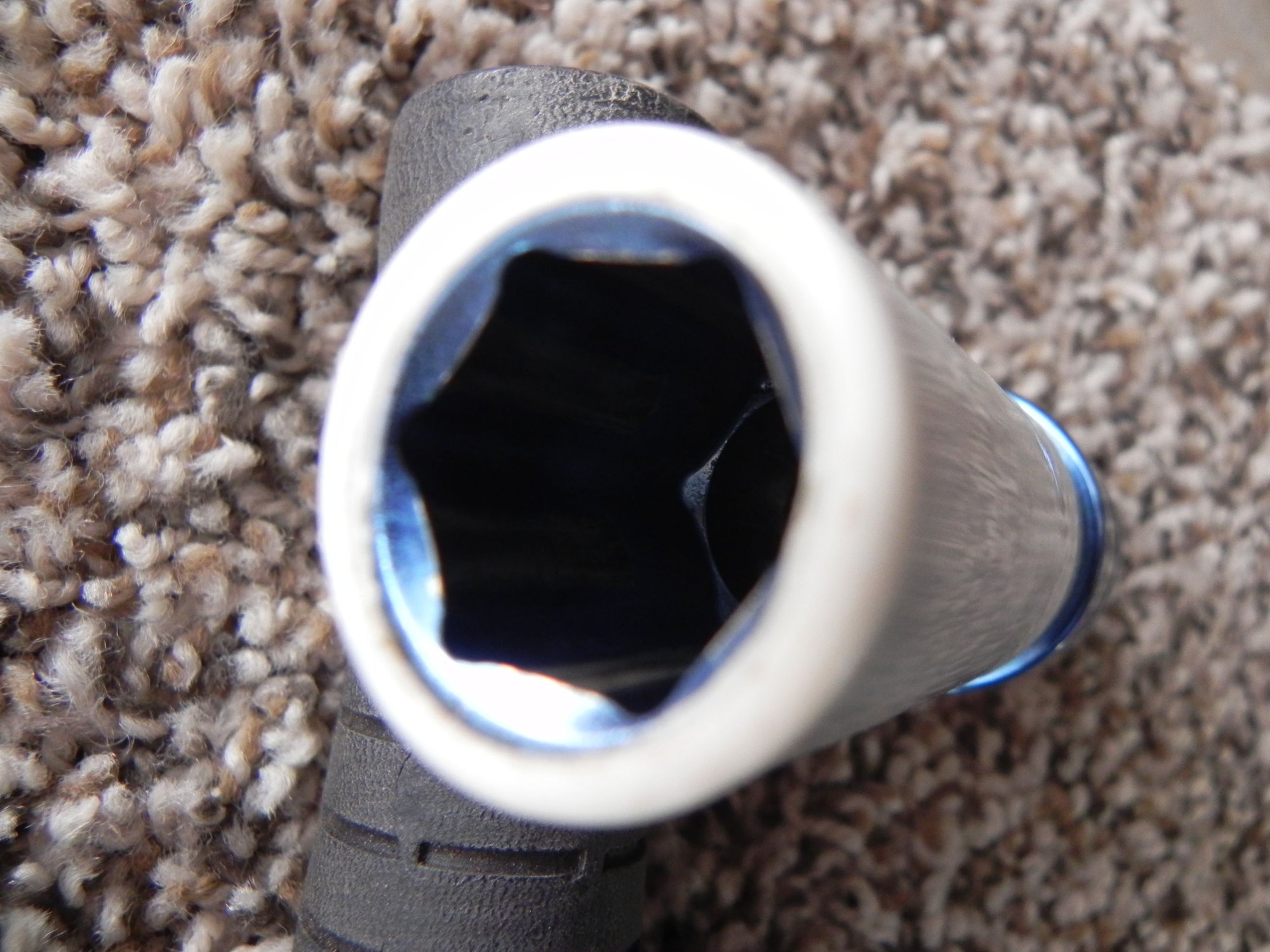

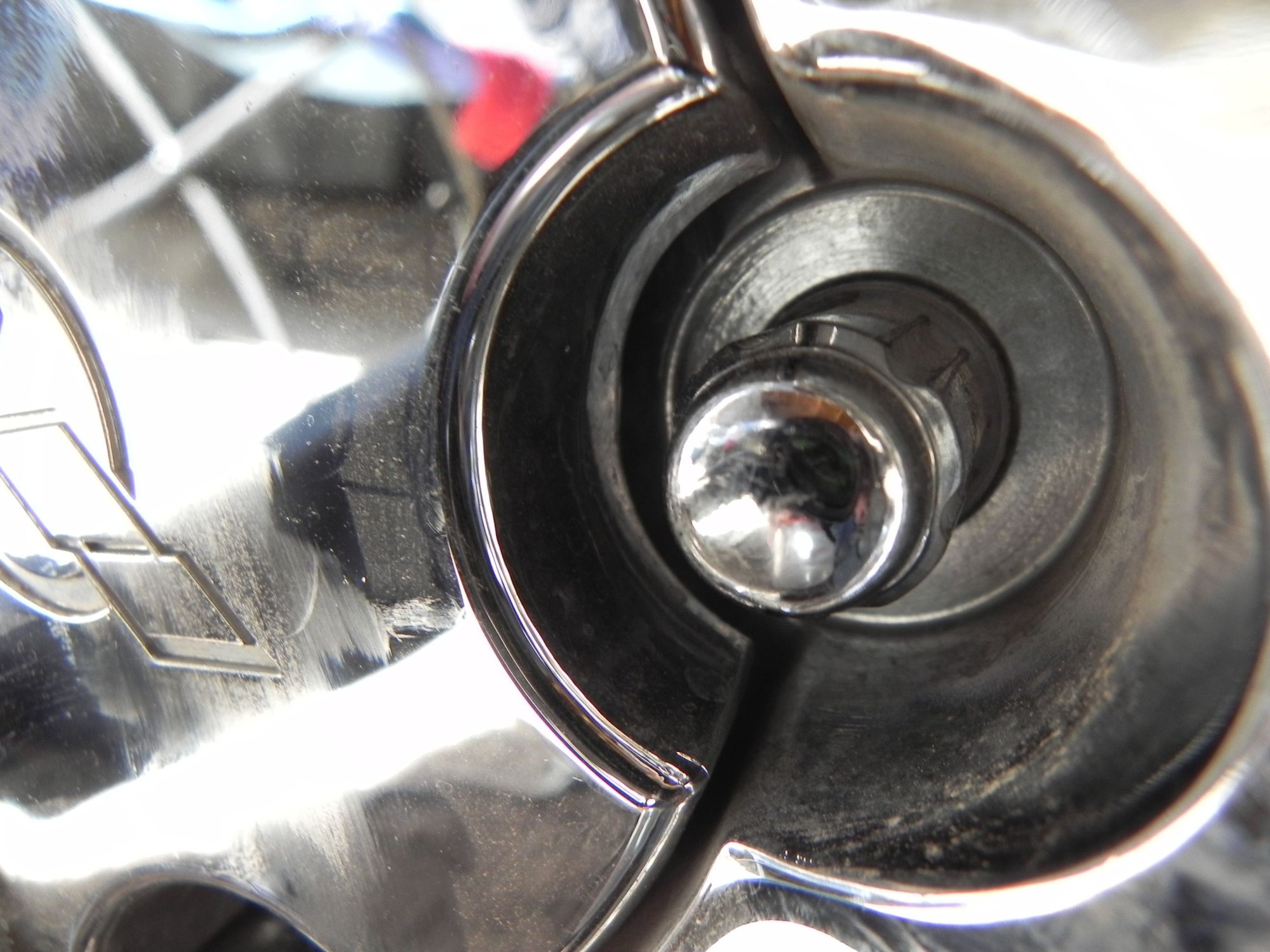

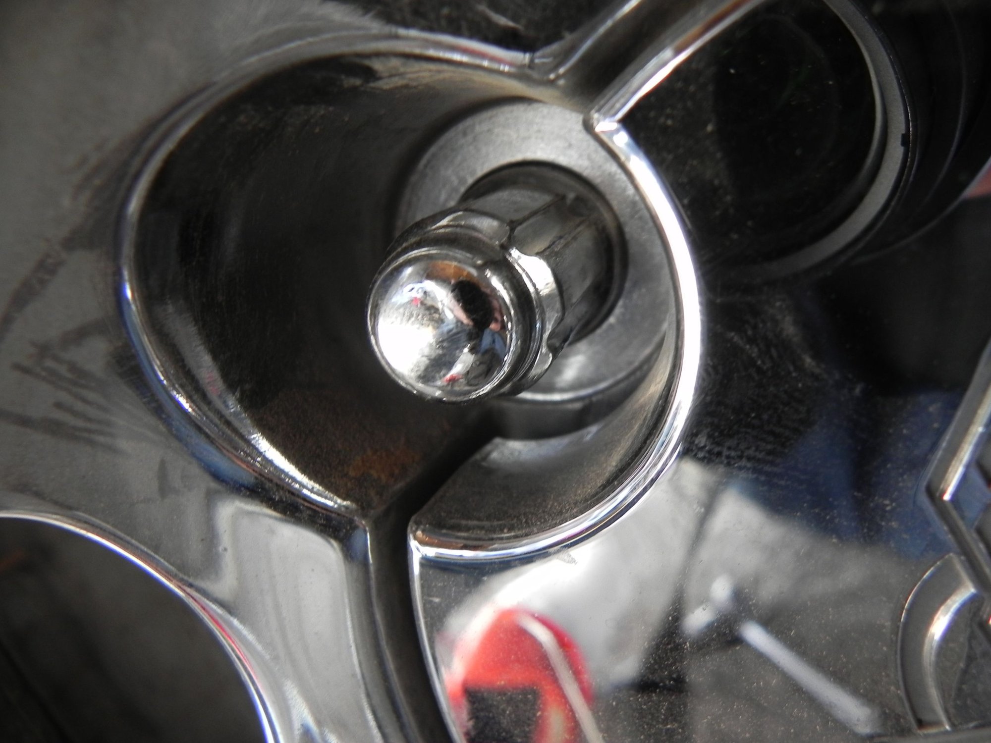

I've had my car 4 almost a months. I took the rear wheels off to fit splash guards.
I bought a 17mm long socket and it fits fairly snug.
When putting the wheels back on, I torqued them to 60 ft lbs, then 80, no real problems, but when I went to 100 the wrench would click and the socket seemed to slip. In fact, it slipped and jammed up to where I could not get the socket off. I finally had to back the nut off to get the socket loose - about 20 minutes to get it off..
See photos.
Do I have the right lug nuts or the wrong socket (Hex, six points?
The nuts are grooved and the flat areas are really minimal in width, which is probably why the socket slips.

Those are spline drive lug nuts. You need a spline drive socket for them. Maybe the previous owner put the socket in the lug key holder, rear trunk area, drivers side, hidden under carpet. If you don't have the key/socket I would just get some new lug nuts, unless you want to try finding the correct socket.

go to autozone/oreilly/etc and get the correct spline drive socket, they should have those in stock... take one lug just to double check but they look to be the generic spline drive "tuner" lug nuts as they are commonly referred as... do not drive the car until you get the proper socket or new lugnuts and get the wheels torqued correctly
