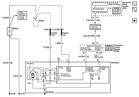

Check the schematic below. There are 2 fusible links between the starter and the alternator. If they are fine, both of them should have battery voltage on the alternator side with engine off. The L wire brings 10v at a limited current from the PCM into the regulator and this is the signal that excites the alternator.
Just a bit of advice: If you verify that your alternator is bad, don't give it as a core. Plenty of horror stories here. You can replace the regulator. Take a look at this post. It has info on the right regulators for both, 97-01 and 02-04. The price is around $30.
