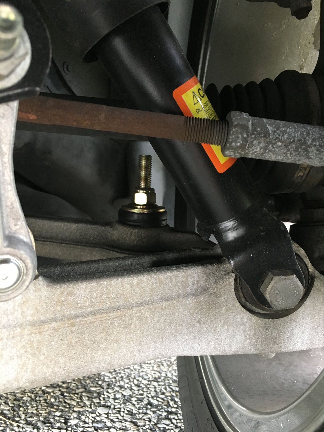

Not sure what is going on with the lowering of your car, you should be able to slam it with those Eibach bolts. After looking at the pics, I know for a fact that mine is lower using the stock bolts, fronts 1/4 turn from bottoming and 2 threads exposed on the rears. Has it settled anymore since you lowered it?
Old Jun 1, 2018 | 03:31 PM
  #34
C5 for life's Avatar
C5 for life
Joined: Feb 2018
Posts: 699
Likes: 20
Well it seems with an inch and 1/8 if thread remaining in the back to further lower it, and with the front bolts completely bottomed out. I lost.
Old Jun 1, 2018 | 03:35 PM
  #35
C5 for life
Joined: Feb 2018
Posts: 699
Likes: 20
Correction, they look almost bottomed out in the back to. Brain fart. Could probably go a little lower with the nuts but that will change the already sub par rake. I was told 6-8 threads exposed will give it a 2 inch drop. Doesn’t seem to be the case.

The ground is not level but as a reference this is how low the front is and yes she’s got some batte scars.

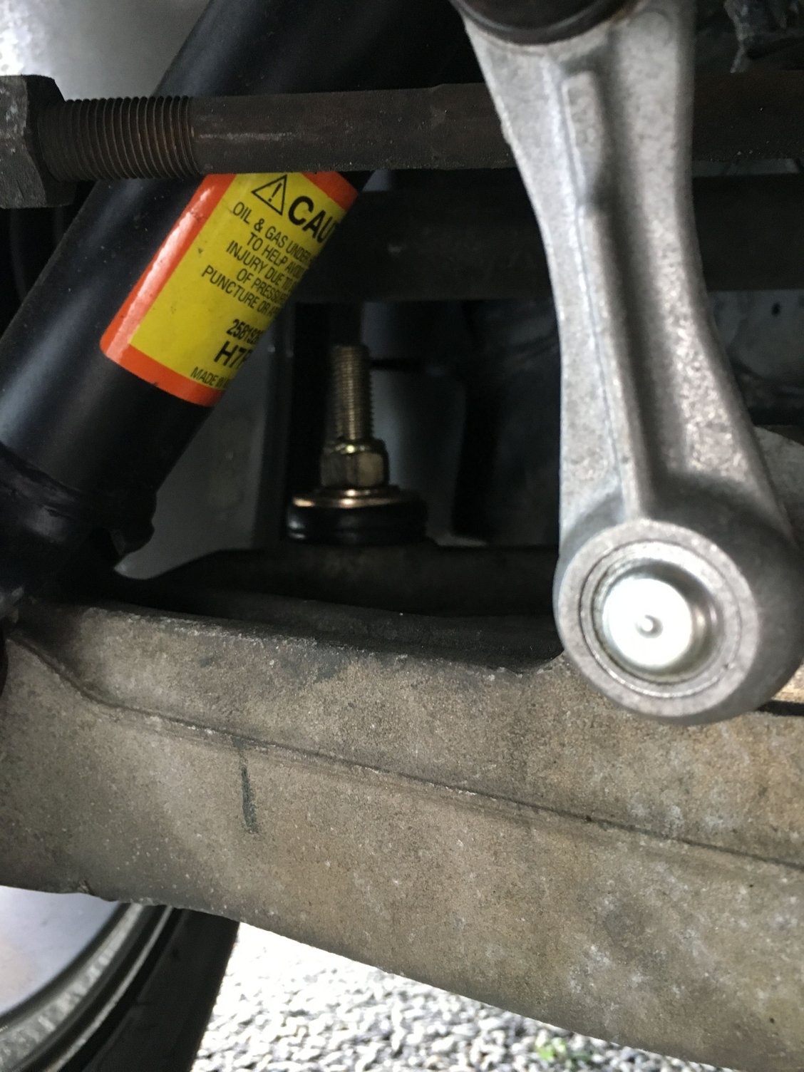

Default Thread reference in rear bolts
it looks like they are just about to the end of the threads.

Current stance after a couple days of driving. Not satisfied looks like to much space above tires. It’s no doubt lower but I expected to have more adjustment space to fine tune the rake. It is what’s it is.

Would the drivers side pirch that the rear wheel upper control arm sits on being out of whack from the accident be the culprit ? The frames straight, i was with the car from the auction purchase, to the frame rack and body repairs. So the pirch issue was the only problem that wasn’t fixed to factory spec because the new quarter panel was put on already and the guy didn’t wanna damage it trying to I guess pursuade or bend the pirch back to its factory position.

How about a picture of what the leaf spring looks like from behind the car, showing the whole assembly from one side to the other.
