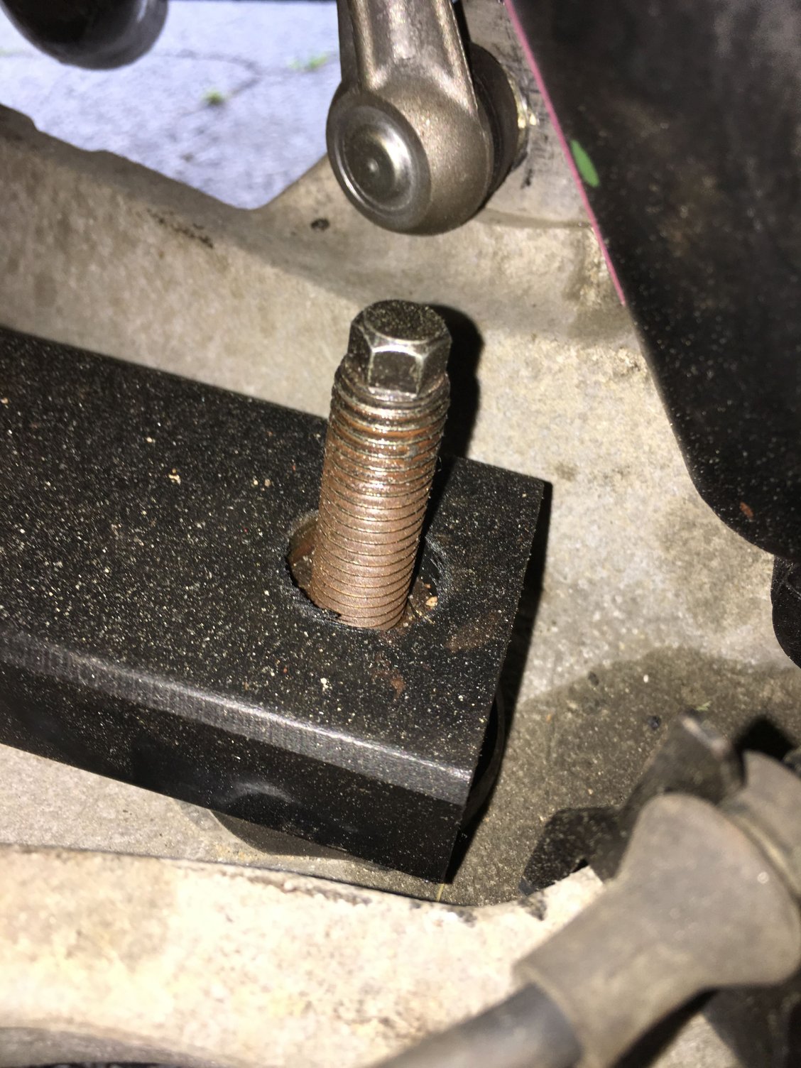

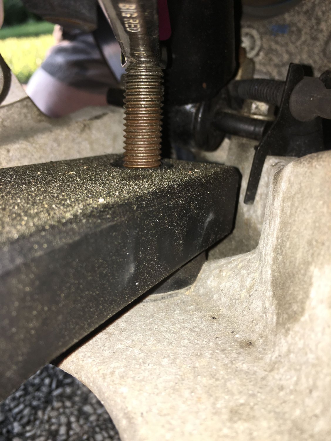

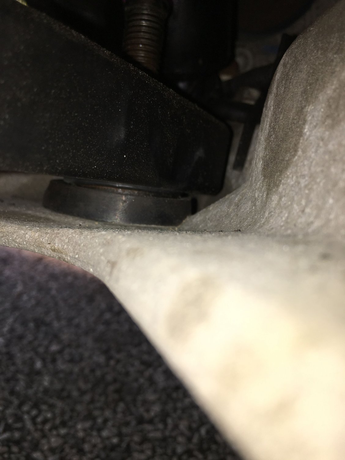

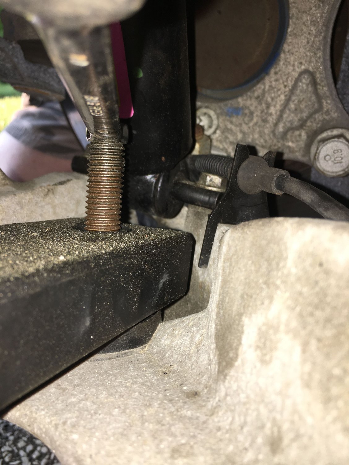

As far as the fronts go it looks like the threads are completely bottomed out. How the hell Can that be?

Yes, those look like they are turned up all the way. This should have lowered it by, at minimum, at least an inch and a half. How much have you driven it since then as it may take a bit more time to settle. Look at Eibachs site, they show 0"-2" of ride height adjustability and i have always seen that and more. You are also correct in that the difference is in the thickness from the stock rubber compared to the polyurethane. Did you take any measurements before you started ? Your car has to be at least that inch and a half lower, provided your stock bolts had already been turned to their lowest setting. That would mean that the previous owner had lowered it all the way on stock bolts and that is where you started. Does you car have the correct / factory size tires on it. The front tires should measure somewhere in about 25.5" in diameter.
