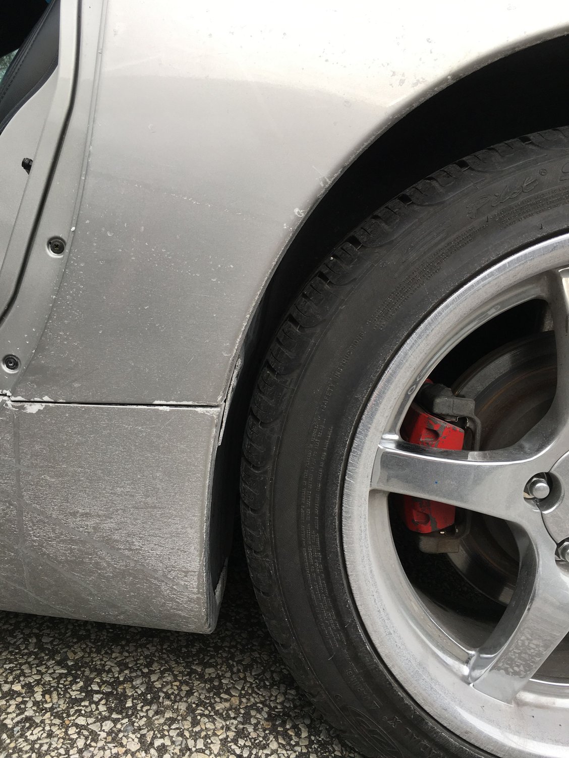

I most certainly have mentioned I have a rebuilt title. I posted pics before and after as well as the space between the wheel well and the driver side tire, in comparison to the passenger side to show the difference as the residual damage from the accident.
The driver side upper A arm pirch it sits in is out of spec. So it causes the tire to sit a bit further forward.

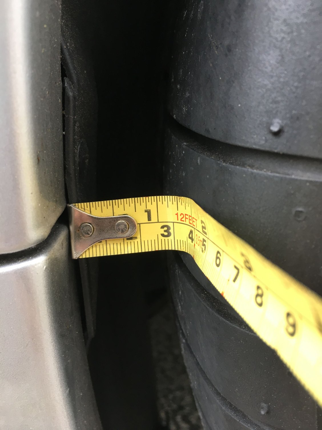

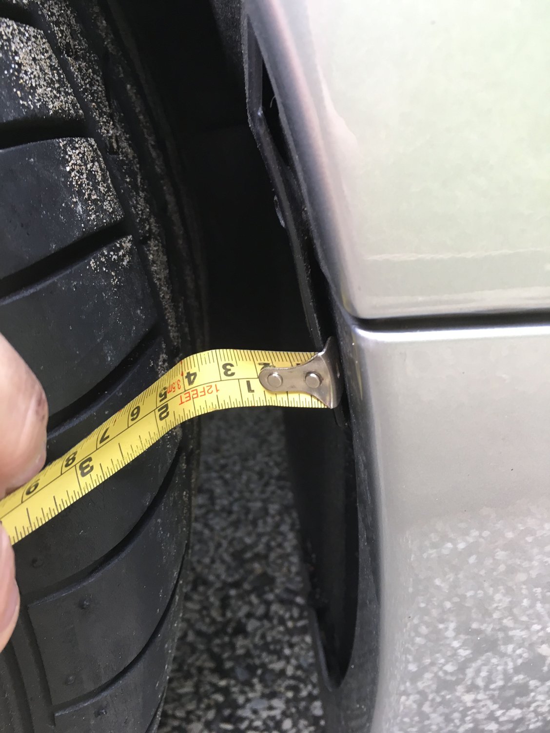

unfortunately, no no picture of the perch but I do have pictures did demonstrate the gap between the tire in the well. Driver side.
Passenger side.

FWIW, on my car, I ran a straight edge across the tread of the tire, at the level of the quarter panel/rocker panel "seam", and the measurement from that straight edge, to the edge of the wheel opening, is 1.5", both sides.
From a factory,geometrical standpoint, won’t the center of the axle to the wheel well be the reference point for equal measurement? Factoring in the difference of tire tread from other vehicles for specific measurement . If you are in fact going off of the tread of the tire.

I have the OE sized tires on mine, and they're fairly new, so there's pretty much full tread on them. But even the difference between a worn tire, and a brand new tire, in the way I measured the "fender gap", would be half the total tread depth, which would be about 1/4".
However, the body panels align of the body tub, which aligns off the frame. So I would think that if the rear quarter aligns correctly with the door, the quarter panel is reasonably aligned to the frame. Therefore, any wonky measurements would indicate something is bent in the suspension cradle.

If the drivers side rear wheel, upper A arm perch is apart of the “suspension cradle” you are correct. These were the best one handed pics I could take for measurement representation. Driver side looks to be about 1/4 inch to far forward. Driver side
Passenger side

Measuring to the edge of the rim at the point where the rocker & quarter panel meets would probably be easier, & probably more accurate.
