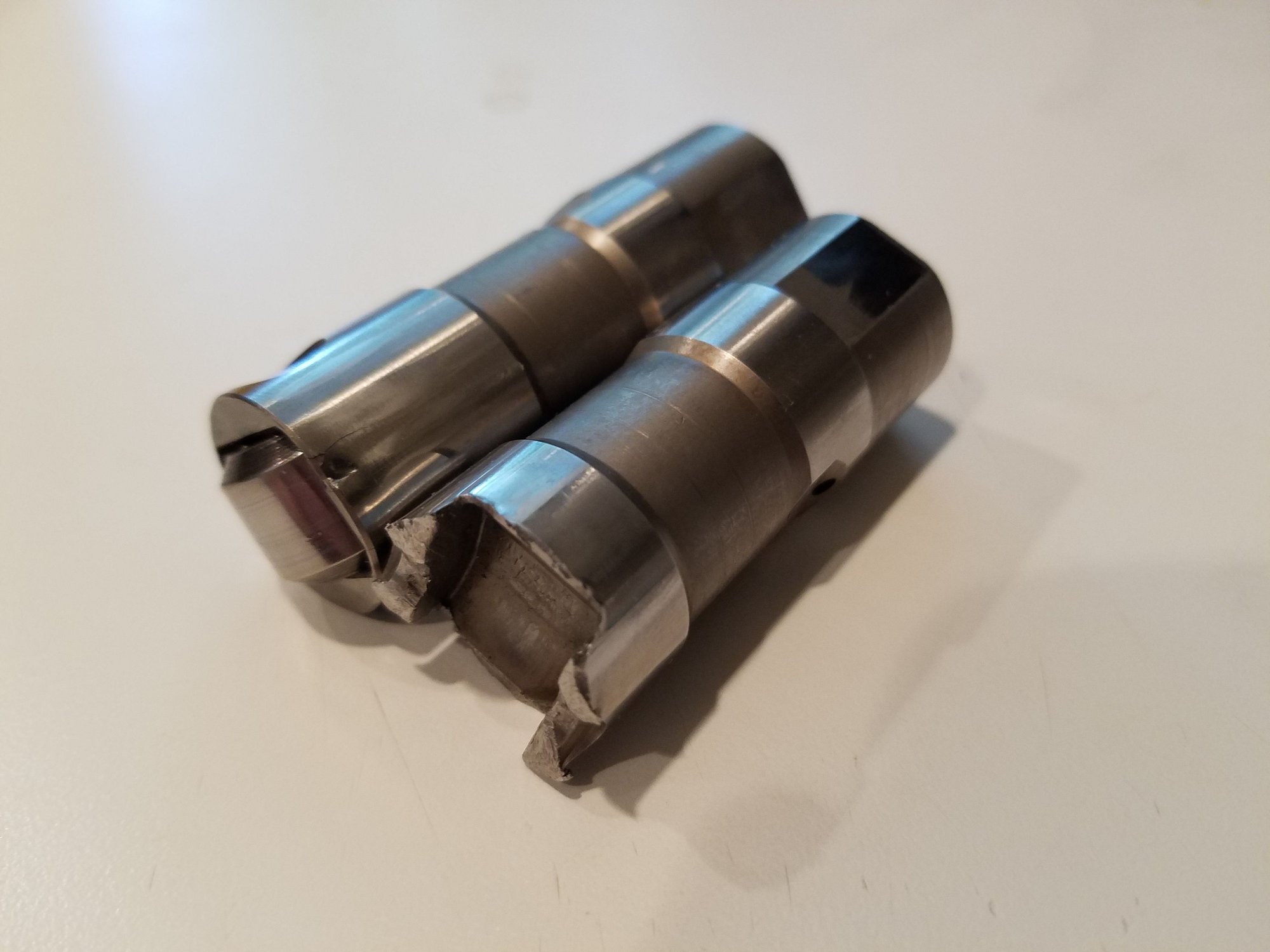

A roller exploded off of a lifter on #8 cyl. Pieces damaged a second lifter, ate the cam, and oil pump.

Ouch. I'd be concerned about what caused that to happen......that's definitely out of the norm.

Not really. It's been a DD, and has seen 6 track days a year, for the last 6 years. I think it just wore out.

Don't pull that lifter out from the top. Pull the cam and remove from the bottom if possible. You might destroy the lifter bore on removal if that lifter has been damaged.
Not sure what your total setup it, but if you are running 5/16" pushrods at high RPM on the track with aftermarket springs you may have been lofting the lifter so I wouldn't be too quick to simply blame the lifter. You probably need to review the entire valve train setup.
We did have to pull the two lifters from the cam journal and out a valley hole.
I can't speak to the top end setup. I defer to my highly competent engine builder. I'm sure it was correct. He has been building high HP Corvette engines for more than 20 years and is a degreed Mechanical Engineer. I completely trust him.
