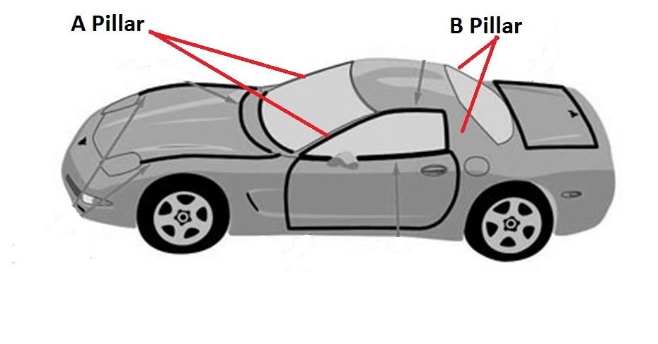

You had me scratching my head there for a moment when you said " A & B Pillar" The front frame around the windshield is the A pillar, the frame of halo behind your head is the B pillar....so you know for the next time

Thanks for clarifying that, I thought the "B" side was front passenger!
