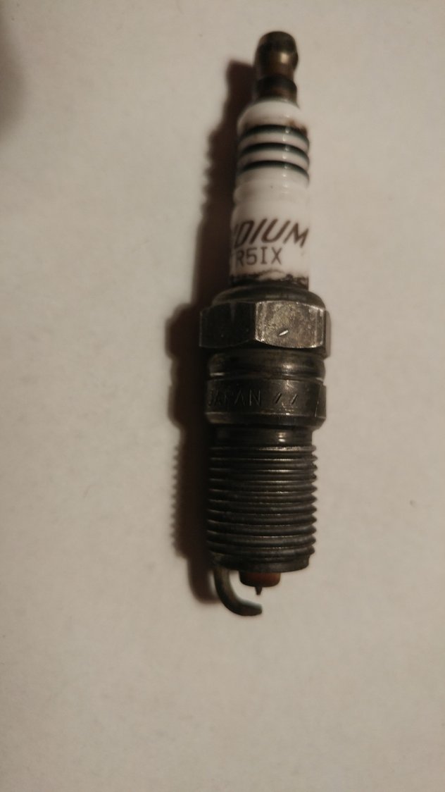

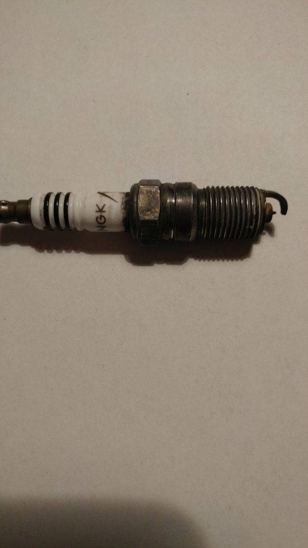

Old Jun 22, 2018 | 09:59 PM
twisterclay777's Avatar
twisterclay777
6th Gear
Joined: Jun 2018
Posts: 6
Originally Posted by Simtech
Mainly just subscribing to find out what happened. Is it possible that the plug was backed out for a while, the ticking was an exhaust leak as the plug got close to coming completely out and the threads have carbon built up in them from the plug being backed out. Where the threads on the plug that blew out damaged? Pics of the plug and head would also be great.
Here are pictures of #1 plug that blew
I would be more concerned of what the threads in the cylinder head look like !!
