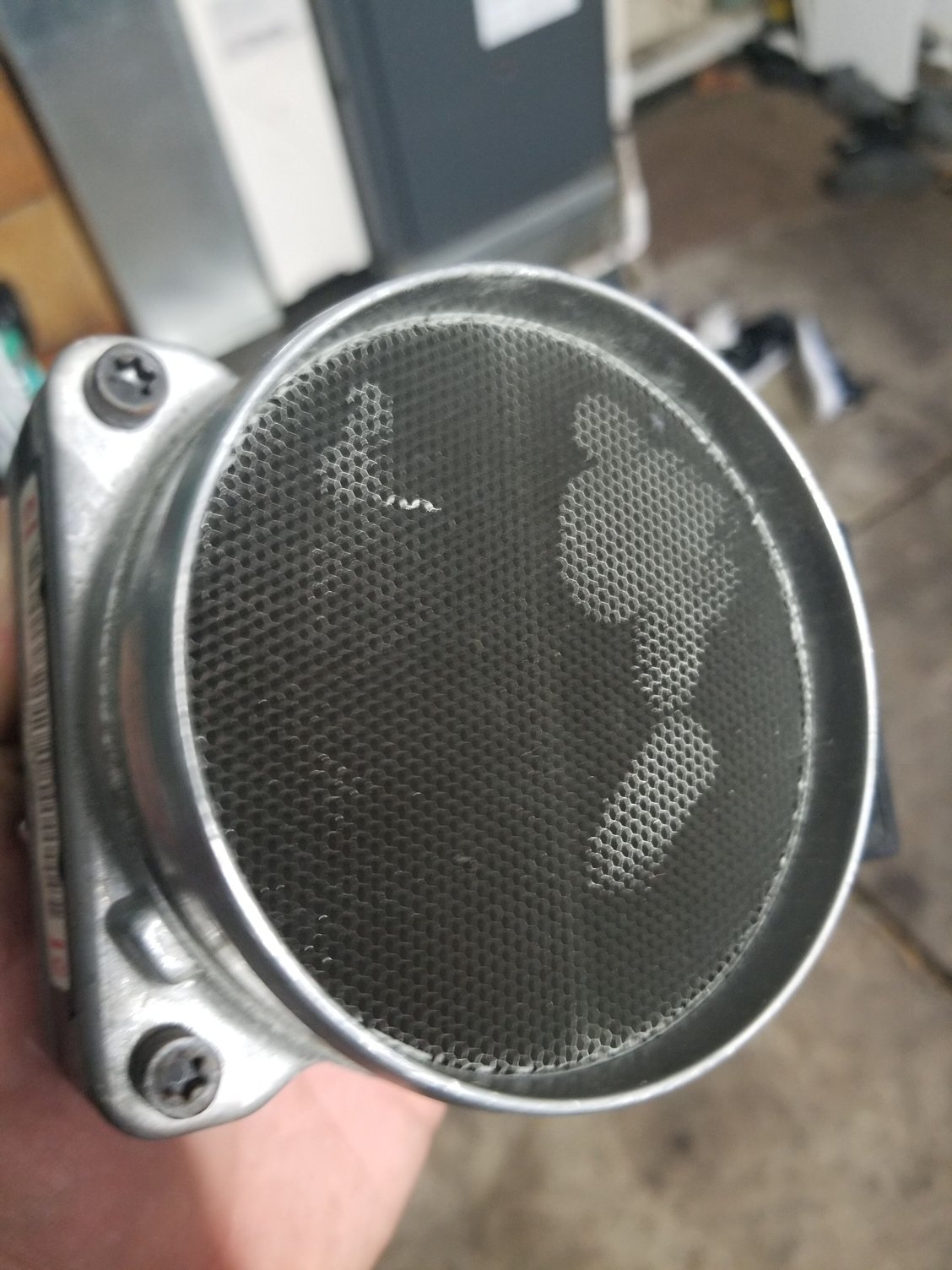

Sorry for the late update. Went on vacation. Before i left I cleaned the mass airflow sensor and saw massive improvements but still wasnt 100%. I ordered a new ac delco one and it was waiting for me when we got back from vacation. PROBLEM FIXED. She is running great again!!

Heres a pic of the old one covered in dirt and oil. Inside was even worse.
