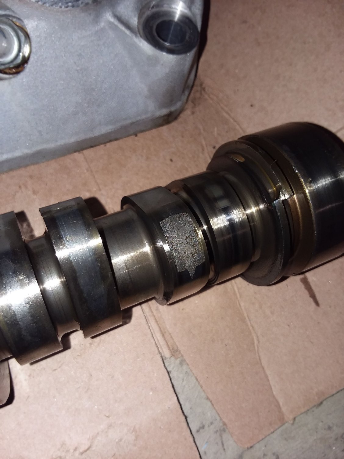

I've been slowly picking away at this project. Pulled the cam out last night and slid ny new one in. Here's some pictures of the damage that I found.
Looks to me like the metal at the peaks of the cam lobes was starting to break down/crumble. Must have been a bad casting or something .

That’s odd. Were any of the lifters hard to roll?? Weird that several lobes look a little scuffed. This was a stock cam car right? Depending on how bad those pushrods that were bent the lifters could have been “lofting” at the Bottom of the lobe only to be smacked back onto the ramp side of the lobe Know what I mean? Which the wheel and cam would surely be at different speeds making the lifter wheel skid? Idk. I’m spitballing here. Lol Either way glad you got her ripped apart haha. now is the time to give the old girl some “while you’re in there” sprucing up lol. Also I think my cam was a 235/243 .630/.610

All the lifters rolled nice and smooth. The bent pushrods were not on the damaged lobes surprisingly. And yes this was a bone stock engine with 108k miles on it. Im waiting on an oil pump and cam thrust plate to show up and it will be going back together. Definitely cant wait!

Ah crap I edited my post while you were posting lol. But if all wheels were fine I would think that you had some sort of heat or friction that broke down the lobe or roller wheel. The lofting sort of thing made some sense to me. Lol but stock car shouldn’t have these issues. Who knows. That’s a nice cam you picked though. Bet it’s great for cruising. Keep us updated and let me know if you want my map table and or tune file. Although I’ll probably be Adding a touch more fuel than you’ll need it’s a good start
