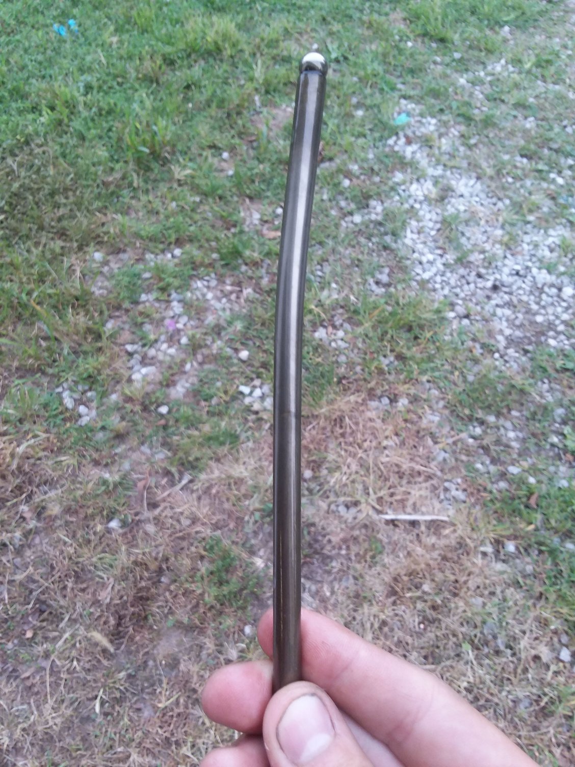

Think i found my tick.
Yep I believe you did. Glad it wasn't something more serious, I expected to find this on mine, but have yet to figure mine out.
How did you know which one to check? Or did you just pull them all?
Old Aug 20, 2018 | 08:02 PM
  #51
Millhousemx's Avatar
Millhousemx
Joined: Jul 2018
Posts: 78
Im glad too. Hopefully the cam and lifter are ok since i know its been driven like this for a while. I figure if I replace the pushrod and it runs quiet its probably fine.
Thanks man, I may take you up on those comps. I guess I need to check the drivers side head too. I replaced the pushrod on the passenger side and fired it up. Sounds exactly the same lol.... i hate this noise!
So you replaced the bent pushrod in your pic but the noise didn't go away?? That sucks, maybe you have multiple ones bent a little?
Old Aug 20, 2018 | 09:33 PM
  #55
Millhousemx
Joined: Jul 2018
Posts: 78
Yeah i put a new one in the passenger side to replace the bent one. Pulled the others and they were straight. I still have to pull the drivers side ones though. I just figured id try it and see how it sounded first.
typically they bend on a manual from the good old money shifts. Springs lose control of valves due to mechanical over-rev and the valves kiss the pistons then stuff the pushrods into the lifter. Stock pushrods are weak so they usually bend first before damage to lifter but not always. However you probably have more than one bent one. If so I do recommend getting the comp cam pushrod length checker. They aren’t much and figuring out what length you need. The 7.400s are close to stock replacement length. Also if you suspect a mechanical over-rev be sure to inspect the stock crap rockers as they like to puke needle bearings
Old Aug 20, 2018 | 10:44 PM
  #57
Millhousemx
Joined: Jul 2018
Posts: 78
Well i tore the drivers side down. Found one more bent and changed it. Replaced both with 7.4 since this engine is all stock and thats whats in it. I started it back up and it sounds about the same at idle and blipping the throttle makes it clack a little louder just like before. All the rocker bearings looked good too. Not really sure what to think. It sounds maybe slightly better but not the difference i had hoped for.
