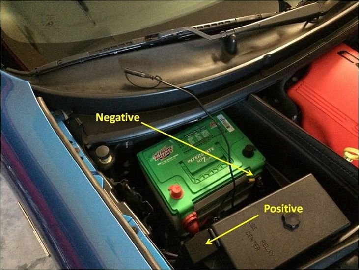

Bob, I hooked my Battery MINDer to my car by using the Terminal ring provided with it. My MINDer also came with an alligator clip adapter and a cigarette lighter adapter. These can be purchased separately if you need extras also. Just be sure to verify polarity if you purchase them from a different manufacturer as all of them are not the same.
I connected the positive terminal (+) to the positive link on the side of the Fuse Relay Center and the negative terminal (--) to the negative terminal of the battery (it was just too easy to ignore). When not in use, I install the cover on the connector and lay it down beside the battery out of the way. I typically rotate it between two vehicles in my garage every other week.

If you want a more permanent attachment for a ground than a battery clip, there is a nice little bolt sticking out of the firewall just behind the battery with a nut on it, just waiting for something to be connected to it. The other ring terminal can be attached at the B+ post on the fuse box (positive arrow in the above post), then just leave the capped connector lying tucked in between the battery and fuse box or anywhere out of the way when you don't need it.
Battery clips and ring terminals don't fit very well on side post battery connections, and these other options are more reliable.
