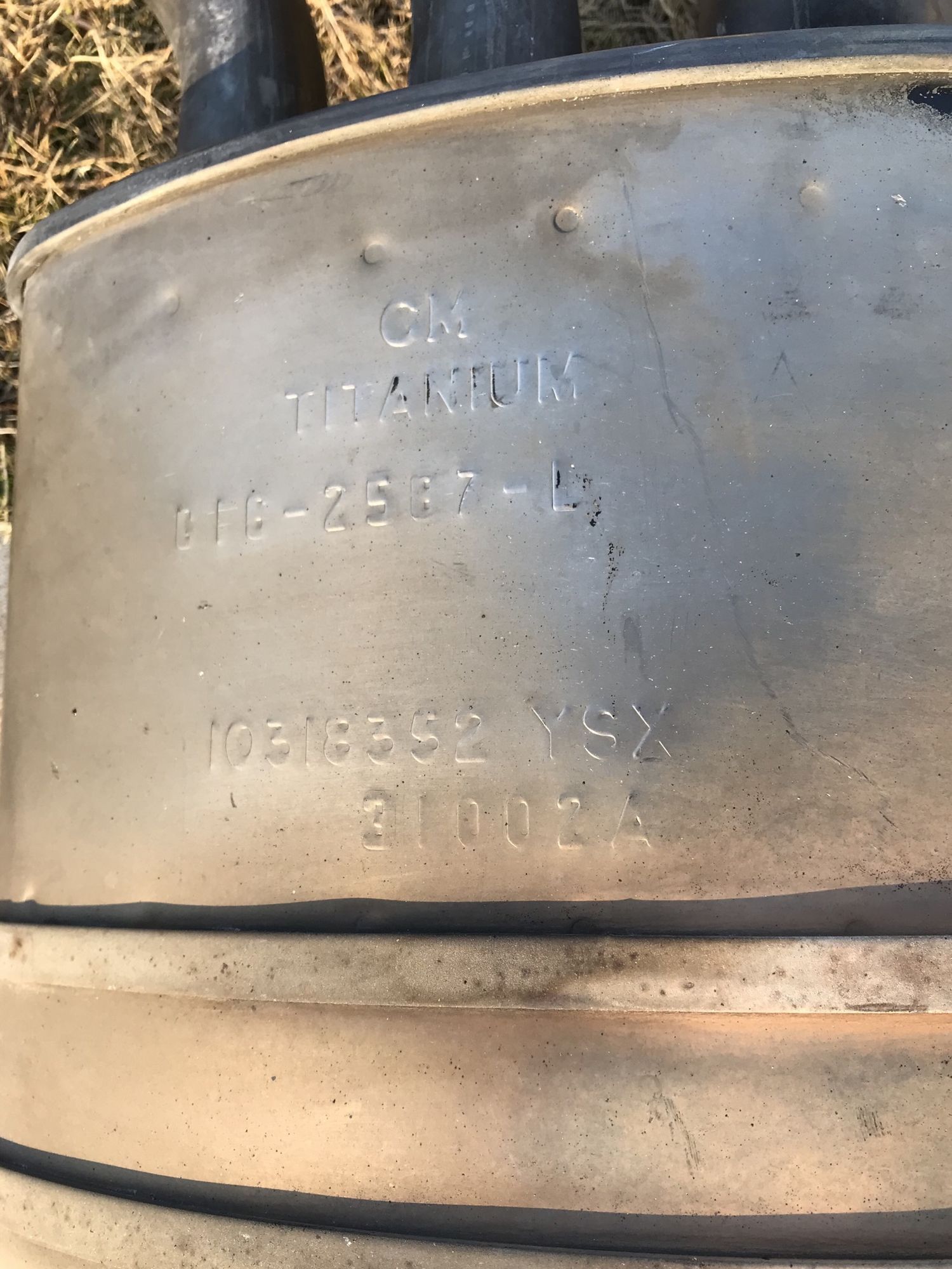

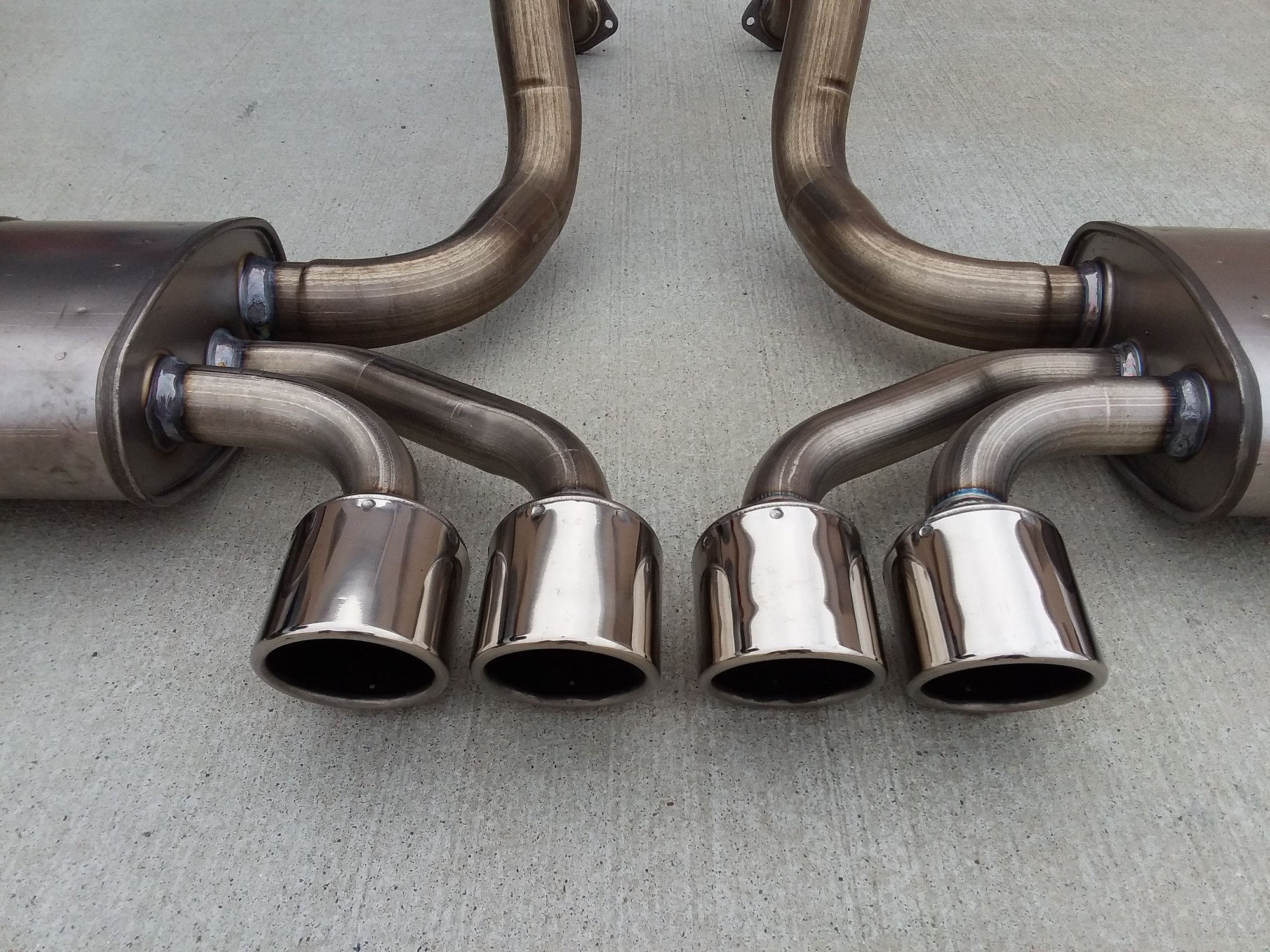

How can I tell if the muffler is from C5 ZO6?

Round tips instead of oval on the z06 exhaust

Per above; Z = round tips, the word titanium stamped on them, and are titanium (which looks like, uh, titanium).

Ti is non-magnetic. Of course, so are some stainless steels.
