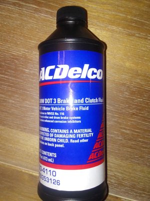

I want to try the correct (oem)oil. I bought some of this but not sure its correct? i need to make sure it has the modifiers in it before i crack it open.
is this the right stuff for a 2001?
10-4110
19353126

The DOT3 is suppose to be what the system was designed for. Some have had that same issues when going with a fancy DOT 4 or the higher priced racing fluids. Hell, give it a try and see if it corrects the issue. YES, that is the correct DOT3.
