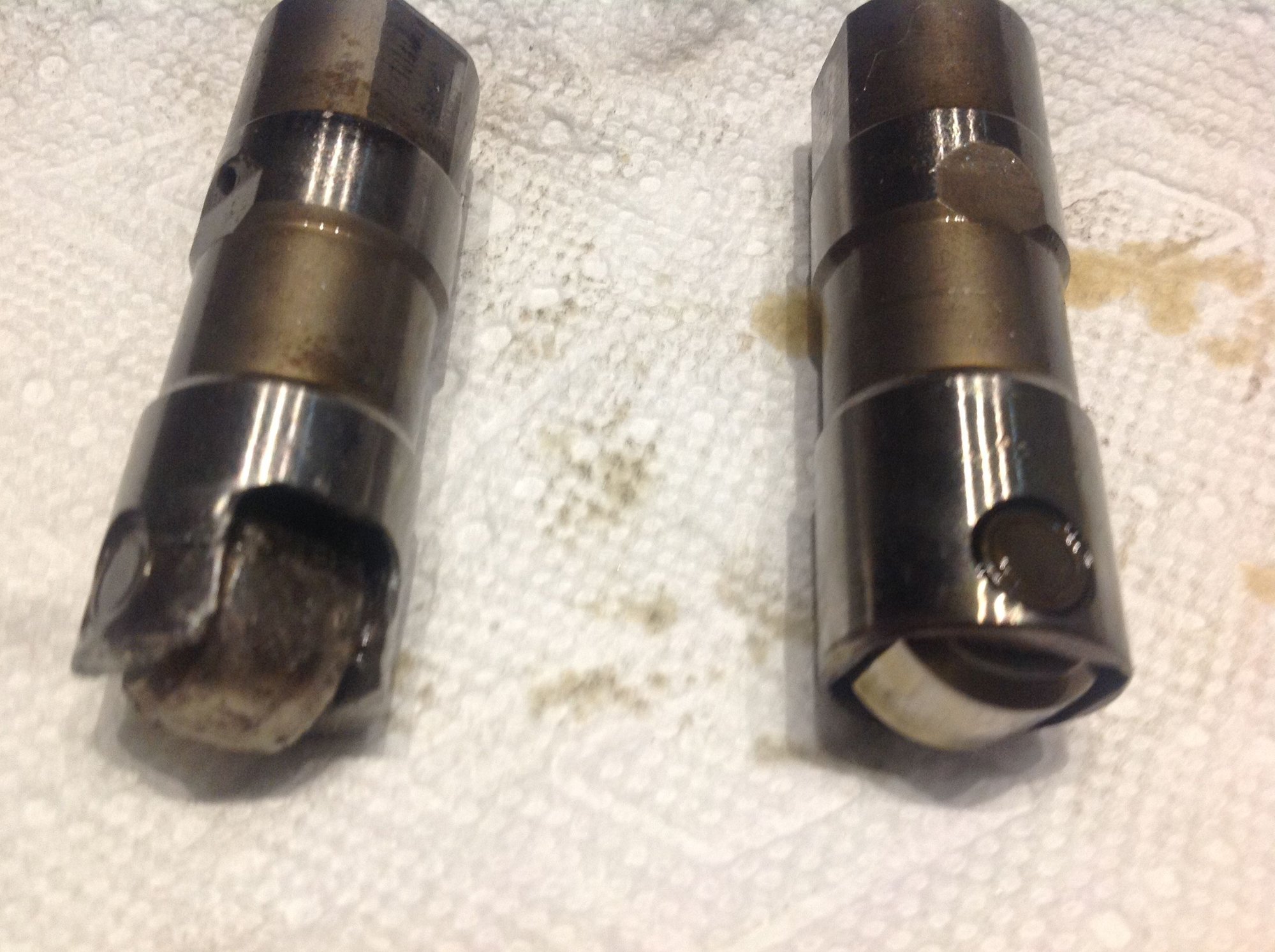

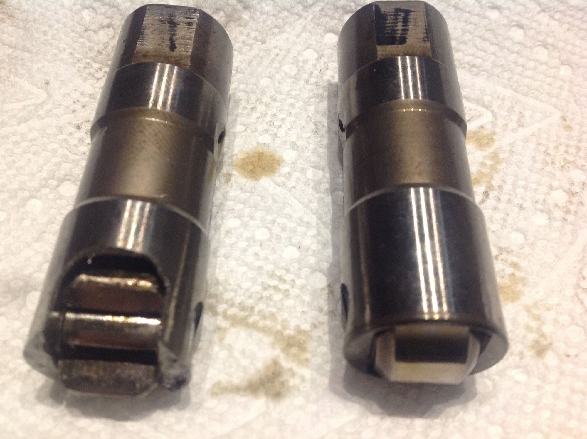

Old Oct 31, 2018 | 01:20 AM
Crabr1's Avatar
Crabr1
Joined: Jan 2005
Posts: 3,315
Likes: 28
From: Wa
Ok how bad is this? I finally got the lifter out after getting the striped Allen head valley cover bolt out. The lobe doesn't look bad at all,but I scratched up the lifter journal pulling the lifter out. The other thing though,part of the lifter was gone,so I'm sure I'm screwed and will probably have to pull the engine for at least a rebuild if not replacement. Here's a couple pics of a good lifter and the bad one.
