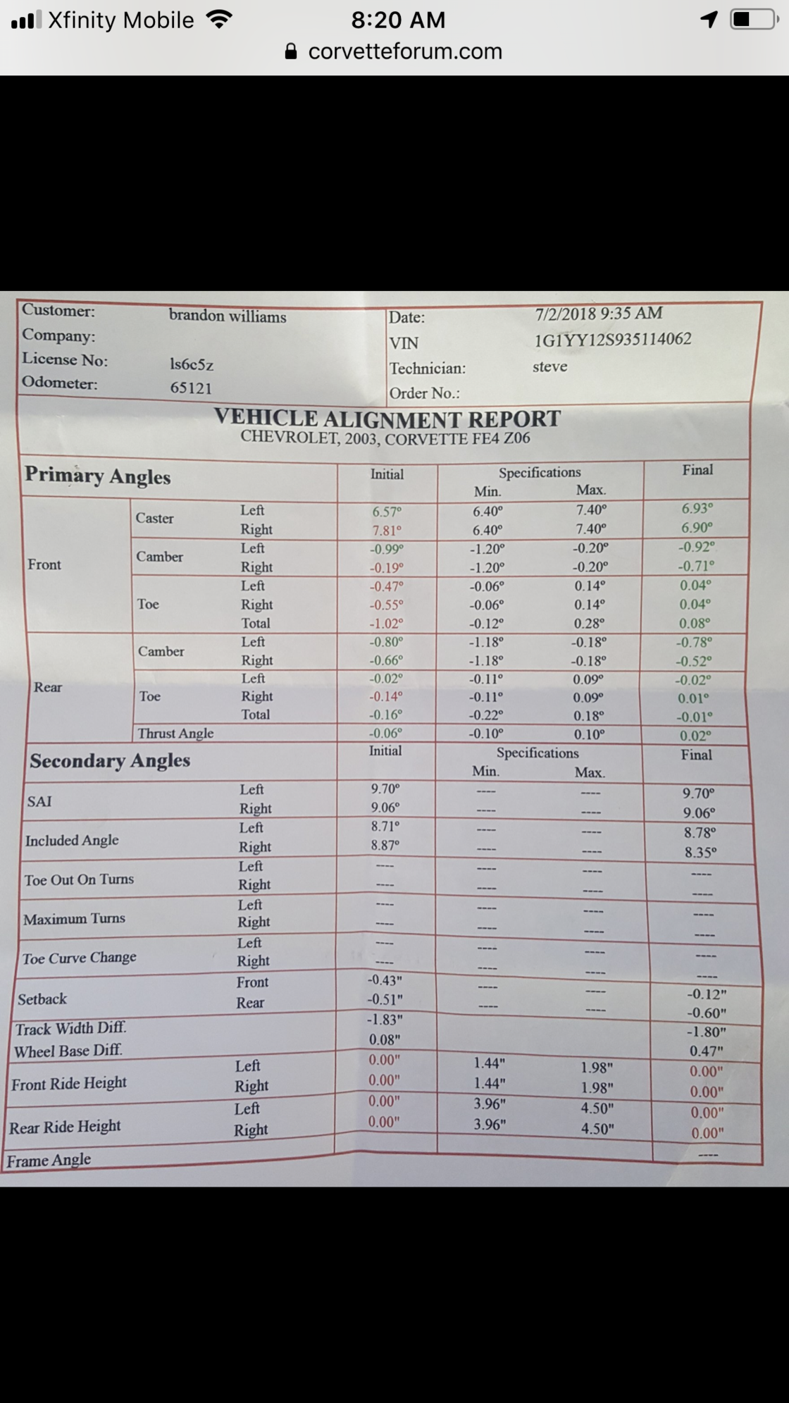

Wide latitude in specs. Could be on the very low end of castor allowance and zero toe. Post up your last alignment sheet result if possible.

Which alignment spec? Can you post your sheet?
