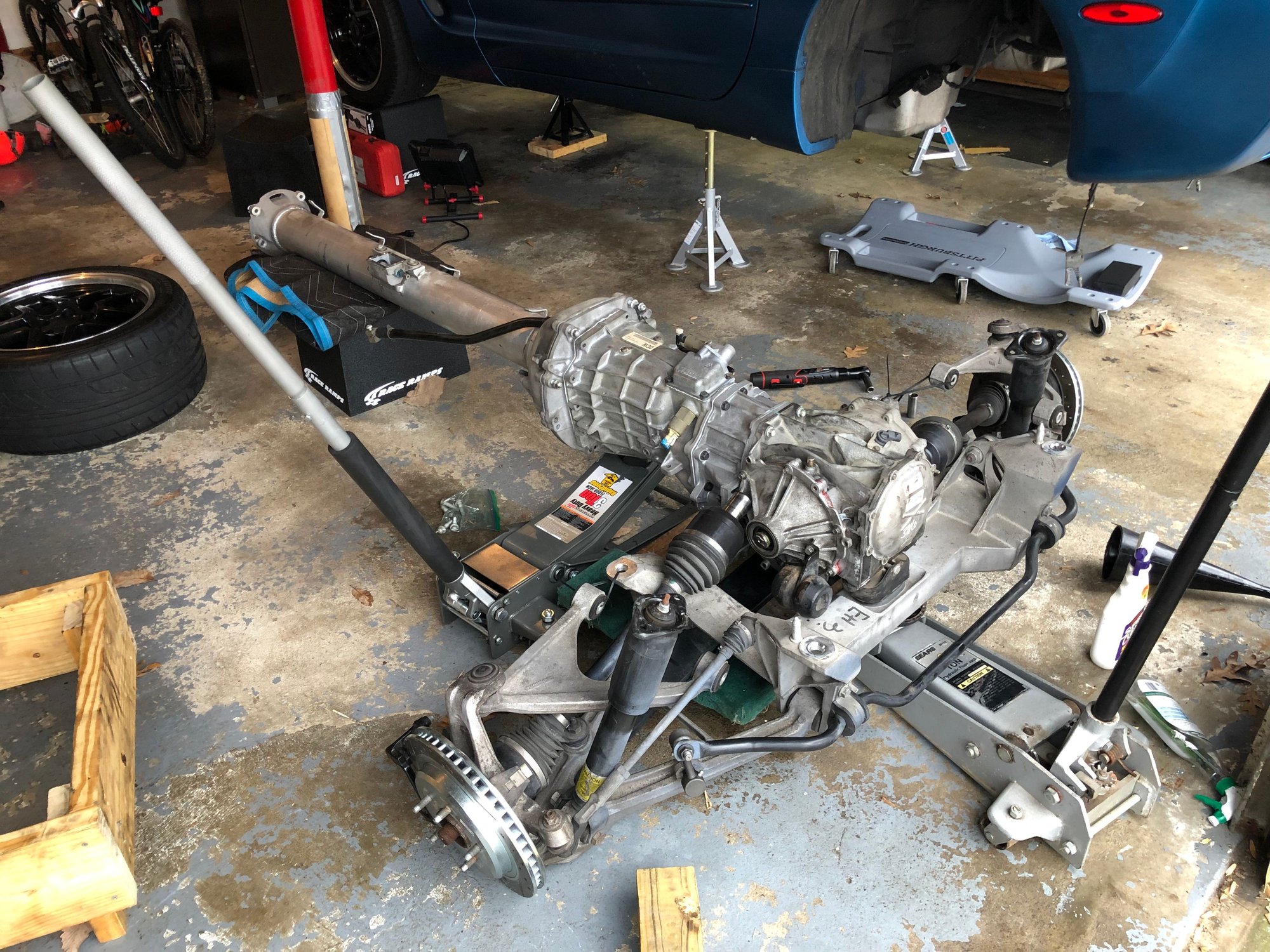

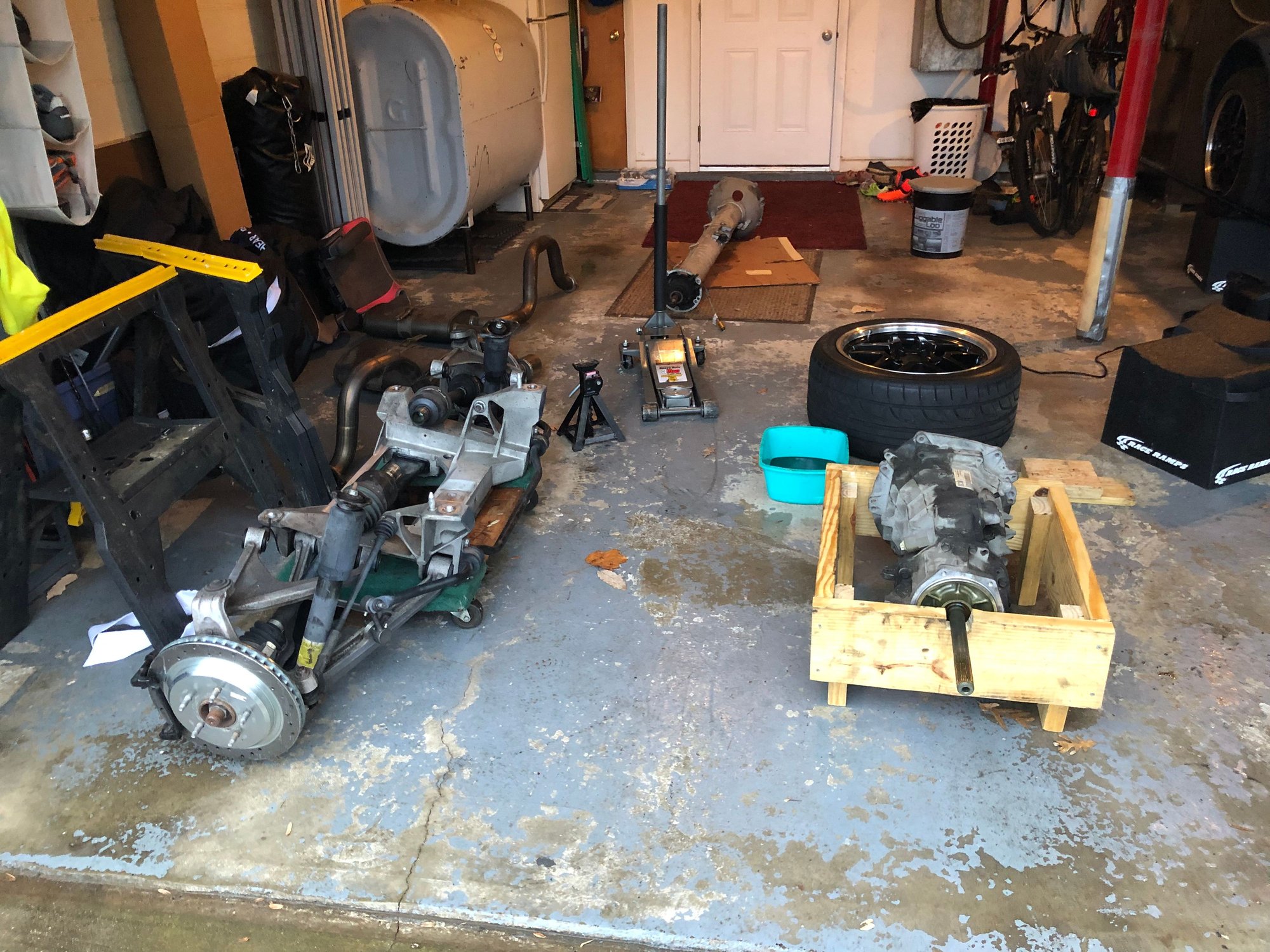

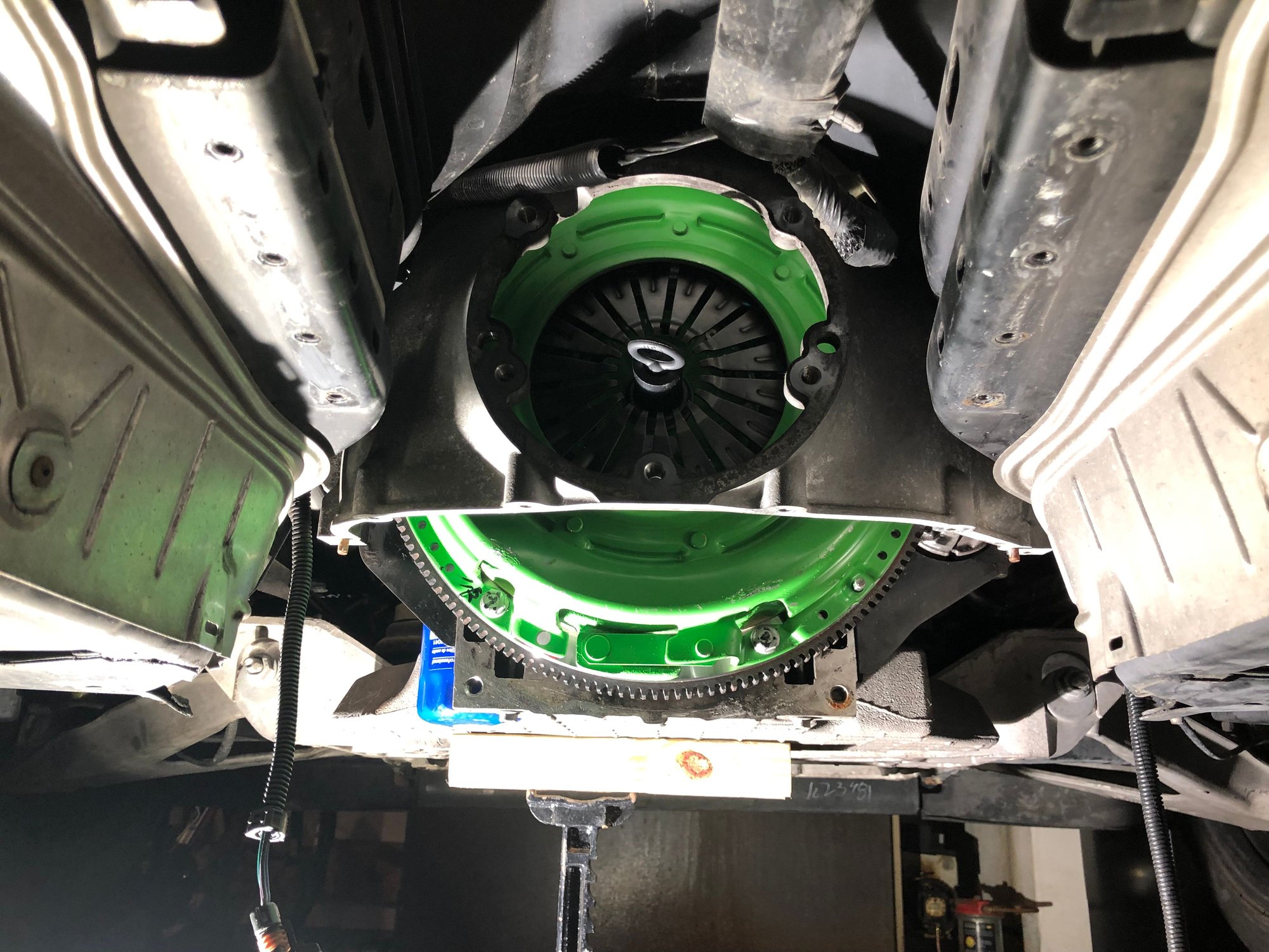

I just did the clutch et al on my ‘99 FRC 2 weeks ago in my garage. It had 80,000 miles on the stock unit.
I replaced the clutch with a monster level 2 and 18lb flywheel. The kit came with a pilot bearing, new bolts and a slave cylinder (measured and no shims were needed). Ordered from Tick.
I also installed a tick remote bleeder.
I had the transmission rebuilt by RKT Performance while it was out.

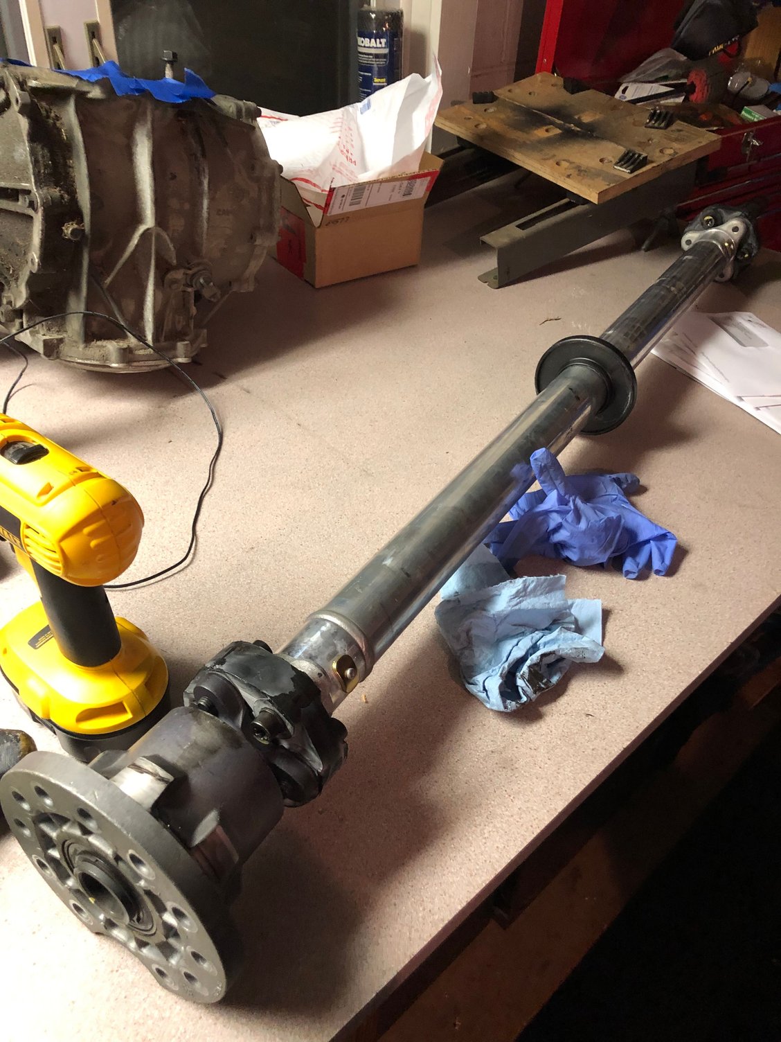

Rebuilt the torque tube with new bearings and couplers.
Replaced both axle seals and the driver’s side O-ring in the differential.
Was as a big job, but well worth the time and effort.
Please PM me with any questions. Feel free to PM your number and we can talk through any questions you might have including part numbers, tips, etc.

The job, while a big one, can be completed without a lift. I did it with heavy duty jack stands that I purchased on Amazon. I had the transmission rebuilt due to a leak between the trans and extension housing plus the higher mileage. I didn’t want to pull it out again. Once apart, it was in surprisingly good shape inside.
Now that I’ve had everything out once, I wouldn’t hesitate to do it again if I needed to.
Like you, I struggled with having a shop do it vs. doing it in my garage. A lift would have made it easier, but there’s nothing like the satisfaction of doing a major repair on your own.
I did not replace any component of the shift linkage.

If you don’t have a press, lineup a machine shop ahead of time to press the bearings off and on your torque tube prop shaft.
Also, I got lucky and my torque tube was the older style with bolts holding it together rather than the enormous snap ring. If you have the snap ring, inquire at a local GM dealer on whether you can rent or borrow the giant snap ring pliers to remove the snap ring. GM designed this tool specifically for this task. Is it needed? No. Will it make the job quicker and safer? Yes.
