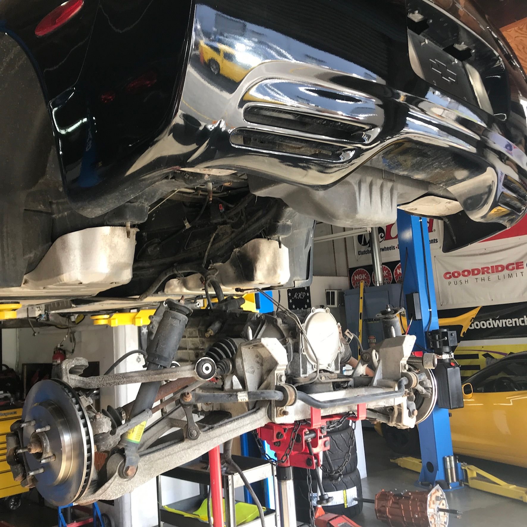

Having my suspension and basically entire car rebuilt around a new engine.
Seems like the options for replacing control arm bushings are:
A) Buy poly/delrin bushings (noisy but cheap/albeit higher labor - still cheaper than B)
B) Replace all control arms ($$$) as the OE bushings are not available stand alone and you must buy assembly
I thought there here was a rebuilding service but if not, who sells ALL OEM C5 control arms (front/back) here on the forum at a reasonable price ?
Thanks for any input guys,

Are those plastic sway bar end links? Going to upgrade those while you're in there? And is that an upgrade trans over to the side? Regardless of which way you go, do fill us in on the final outcome, so those of us bound to reach the same impasse know how it worked out for you.
