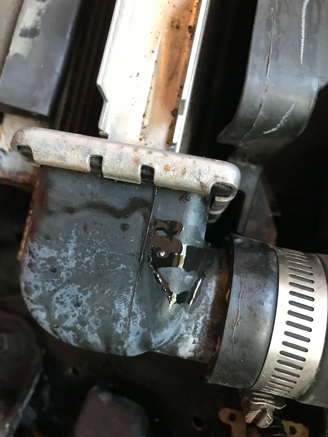

The saga continues. After running the last 2 weeks and not going over half way on the gauge it is now going up to 3/4. When I first had trouble I notice the antifreeze was at the bottom of the plastic tank when cold so I filled it to the line on the tank. I noticed a small amount of antifreeze on the ground after driving around for awhile, just figured I had overfilled. After checking closer I found the puddle was on the drivers side and the overflow side. After some inspection this is what I found. Maybe something like K Seal would work ?
I’ve never removed a radiator so my question is this a replaceable part ? Maybe low antifreeze has been my problem from the start.

No, the tank is not replaceable.. Looks like you heed a new radiator

Are you sure the radiator is leaking? Or is it leaking out the end of the hose?
The biggest problem with replacing the radiator is getting the fan shroud out before removing the radiator. The shroud tends to get caught on a bunch of stuff such as wiring harnesses and other items as you try to pull it out. Other than that the AC condenser just slides upward off the hooks on the radiator.

No it’s leaking right at that spot in the pic, looks like a small crack in the plastic I thought maybe some stop leak would seal the crack. I wipe the leak off and you can see it seep back thru. Never used the DIC, have to look it up in the owners manual.

I would replace the radiator. I know I'm spending your money and time but I would need the peace of mind of knowing it was fixed.
The knowledge of having a cracked repaired radiator would drive me crazy and I wouldn't go far from home in the car.

I’m leaning your way. After 105,000 miles the car really doesn’t owe me anything. The only replacement has been the water pump, thermostat and the holding tank. Not too bad. My wife drives it everyday and now that it’s relocated to Florida I just want it dependable and safe for her to drive. Performance wise except for Corsa exhaust it is still stock.

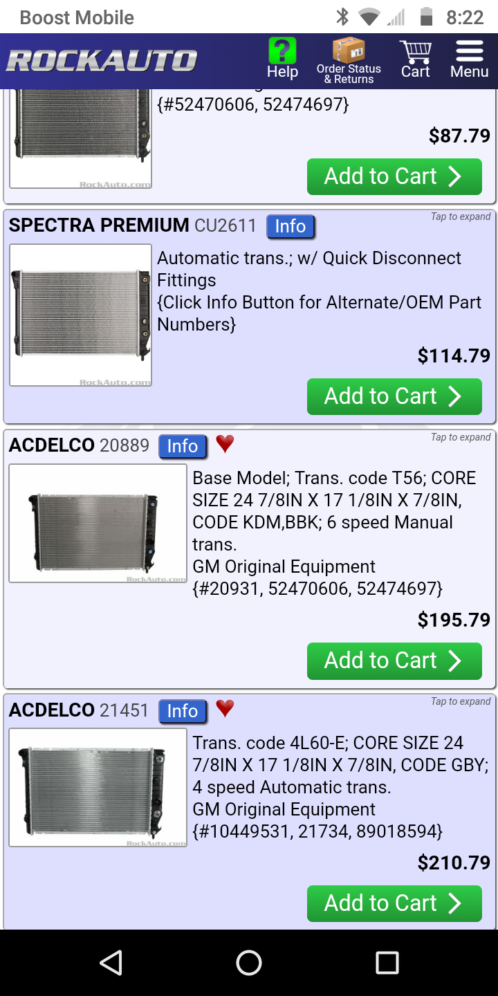

I looked up rock auto for 2004 Corvette.

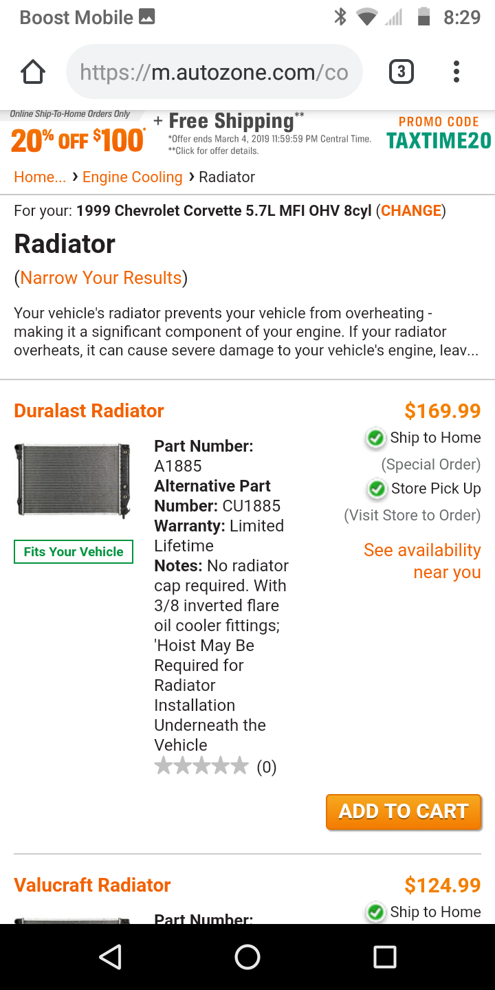

I checked AutoZone also, their "Duralast" is actually Spectra, look at the part numbers.
Also not sure why rock auto thinks that is manual transmission only, it has oil cooler for automatic.

I went to autozone first and they were asking me questions about the transcooler, that made it sound like they were getting ready to order the wrong part, so I just went to the dealer and gave them my VIN so I didn't have to deal with any possible wrong parts/incompetence etc....
