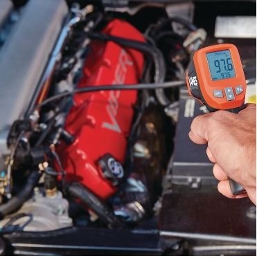

If you are certain that you have no air in the cooling system, then I recommend the following approach;
You will need to determine if you truly have an overheating issue OR a Temp Gauge Indication Issue.
Your can purchase a Infrared Laser Thermometer very cheep at your local HF tool store (don't forget to get and use your 20% off coupon) and you can use this tool to determine actual temps on the various cooling system components.
Start the car, let it warm up and start to laser the water pump/hoses/surge tank to determine if in fact the Temp Gauge is operating correctly by comparing the laser temps to the temp gauge.
Upon gathering this info, you will have a better idea on the direction to solve the issue (Temp Bulb Sensor Drift?) that may be be giving the Temp Gauge bad readings?
