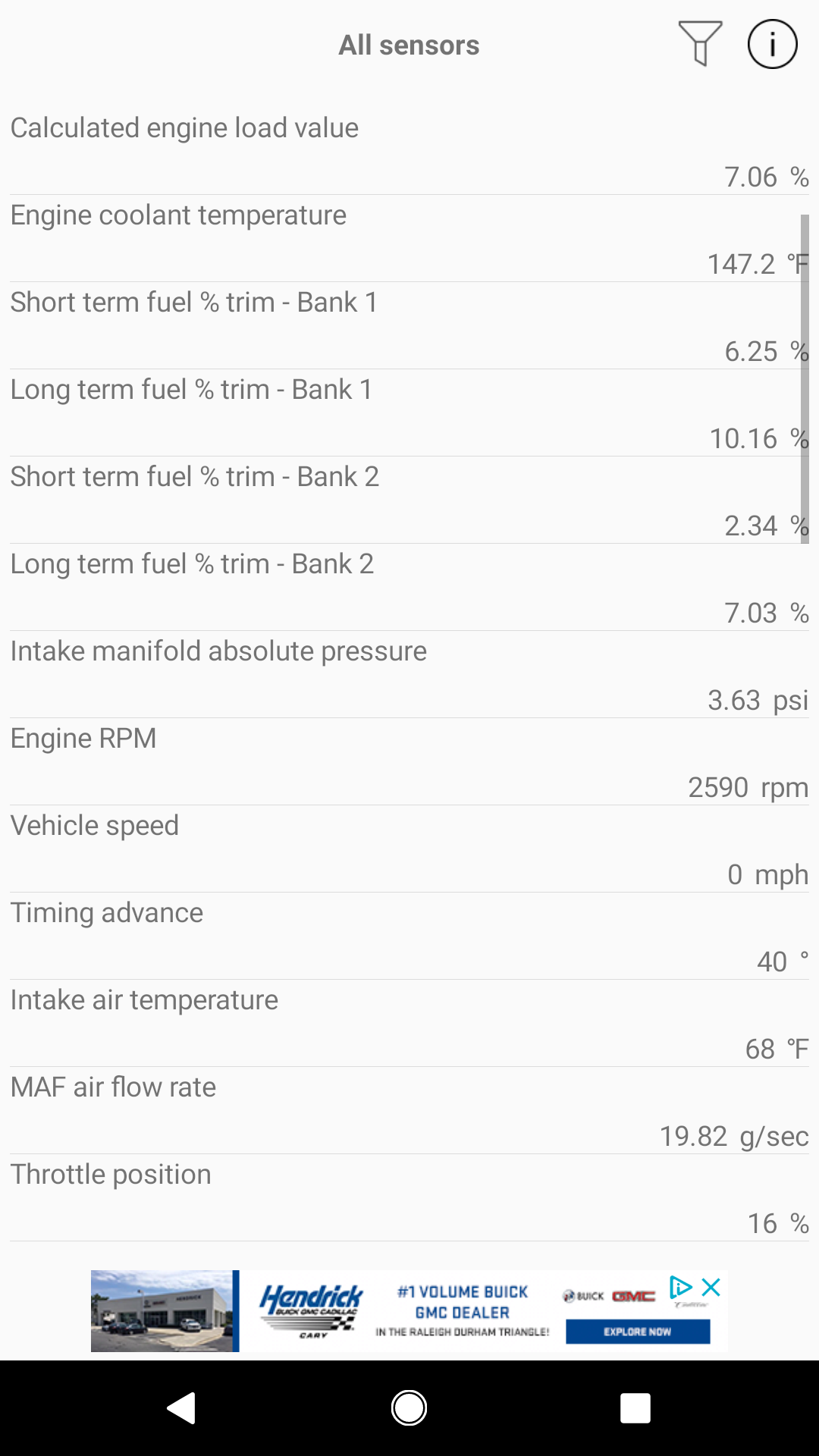

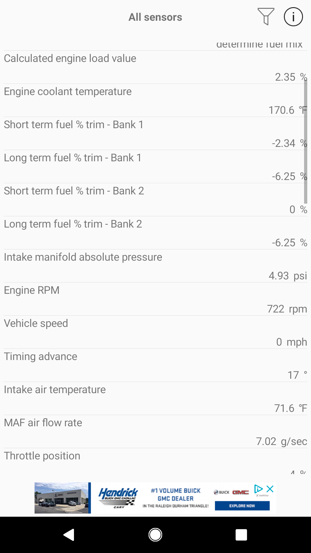

MAF is reading around 7 to 8 g/s at idle. Here's a few screenshots at different rpms: idle, 2500ish, 3500ish

Great info posted !!...negative fuel trims at idle that increase ( go + ) like yours at higher rpm looks like dirty air filter or bad MAF sensor OR fuel delivery issue (fuel pump or filter or injectors)...your car is screaming for fuel at higher RPM's ( +14% - +16% LTFT's)...the MAF numbers look kind of low at 3700 RPM but good at idle ...if you can drive it at WOT (BEST way to check MAF sensor) and see what the numbers are...minimum of around 190 grams/sec are good !!...as far as fuel delivery if the air filter and MAF are good we can look at fuel pump or filter...you have a fuel pressure gauge ??...OH, I have a new Volumetric Efficiency program I just picked up for my laptop a while back...if you can possibly take a snap shot of WOT peak RPM, MAF (grams/sec), outside air temperature, current baro (inches/mercury) OR feet above sea level and humidity from the Weather Channel...I can plug in all those numbers and see if your car is "breathing" properly !!...this will rule our MAF/filter or plugged cats !!
EDIT: MAP at idle looks perfect !!

This is great info, thanks for the help so far. I was able to collect some data this morning. Temperature was 48 degrees, 59 percent humidity, 29.7 barometric pressure. It's about 300-350 above sea level here. The refresh rate on the data was a bit slow, but here's what I gathered for a couple runs. This was driving, WOT. Highest RPM point that recorded.
MAF: 120
RPM: 5900
MAF: 148
RPM: 5300
LTFT went from about -4 at idle up to around 20ish at full throttle high RPMS. I have more data...let me know if other numbers would help.

OK, ran both MAF readings and RPM's and the verdict is...YOUR ENGINE HAS A BREATHING PROBLEM !!....either air not getting in or not getting out !!...coupled with the positive fuel trims I believe your MAF is bad !!...you said you had cleaned it...if your fuel trims went more negative under load (rich condition) I would look for clogged cats/exhaust...your VE was 34% and 47%....80 % is what you want to shoot for !!...if the VE was good fuel delivery would be the direction you would want to go !!..,also we should look at MAF wiring first !!
