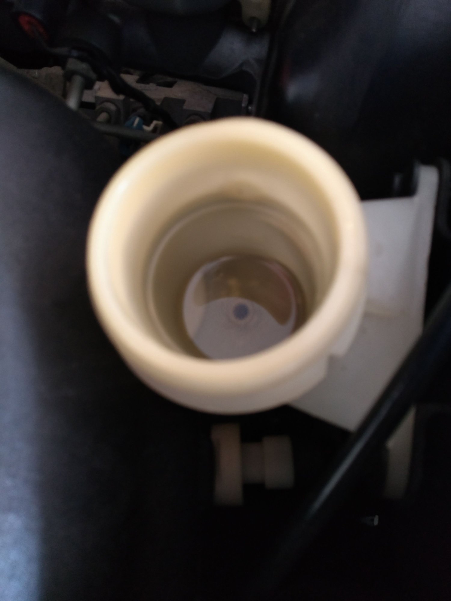

Stupid question, is that line/ridge the fill level?
Didn't see anyone answer you on your question. I checked mine yesterday, for no particular reason, and it was at the bottom of the rubber insert. I thought that was the step they were talking about. Should the insert be fully extended for not?
