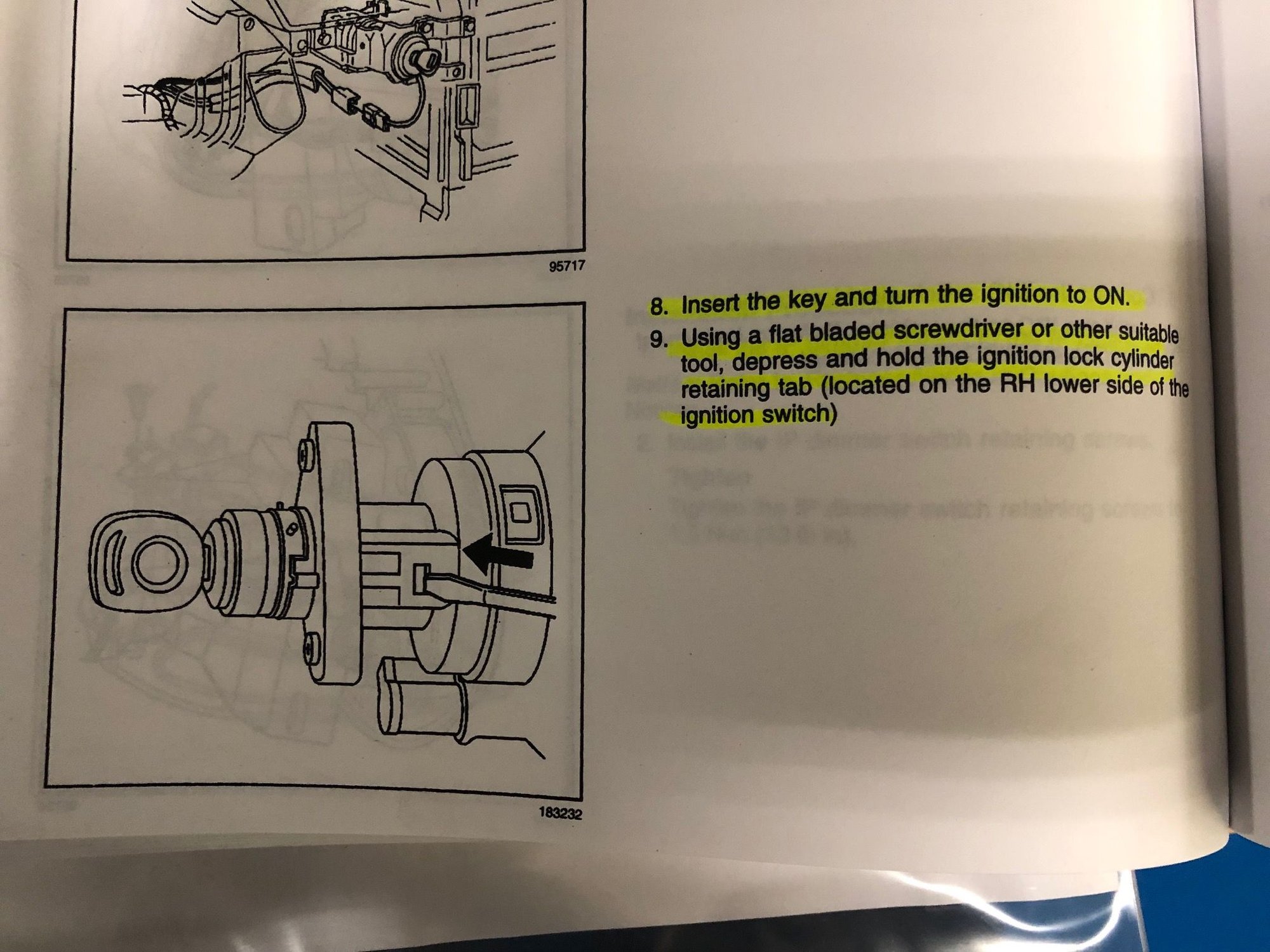

Seems like you have a bad ignition switch contact block, so you do not need to have a new key made as the ignition switch contact block can be replaced with out having to replace the key cylinder.

Gotcha, I do believe the contact block is what I ordered. That’s the part that’s on the back of the cylinder that gets clipped to the two connections, correct?

You don't need another key made !!...when you remove the switch the key lock cylinder is removed from the ignition switch and reinstalled into the new switch !!...this is from my 2001 FSM....and DOES sound like a bad switch !!...if you want to verify a bad ignition switch connect your voltmeter red lead to battery positive and the black lead to PCM fuse #16...turn the key to START and read the voltage drop...should only be a few tenths of a volt max...try it again now between battery positive and the CRK fuse #14 (IP Fuseblock)...you are testing the voltage drop across the ignition switch !!

is what you ordered. And no, you will not need to rekey.
In the meantime, if you need to get down the road, you can actually take apart the switch and clean the contacts off. This is a temporary fix however, and they'll carbonize up again sooner or later. Get a new switch.
