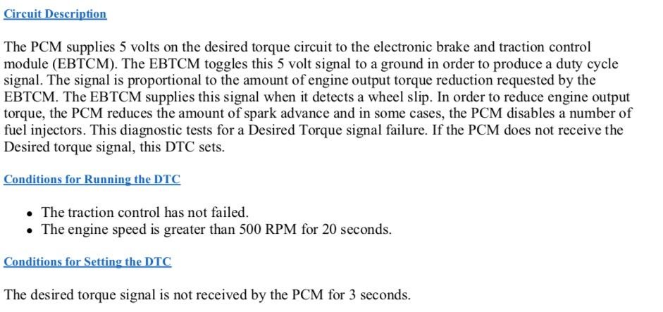

1571 is caused by a lack of control torque signal . The PCM supply + 5 volt to the EBCM . The EBCM toggles this to ground as mentioned below .
You should inspect the PCM and EBCM connector for bad/bad continuity .
If the +5v from PCM is present on term. 25 on the EBCM the EBCM is probably not function properly.
If you had a scann tool like Tech 2 and able to get contact with the EBCM this could probably be verified better
