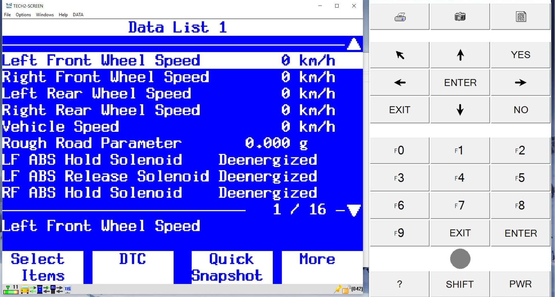

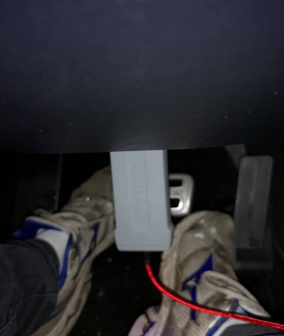

My favorite these days for diagnosting my C5 is using the using the VXDIAG VCX NANO interface (112 USD on ebay) together with the Tech2win fon a 15.6 " screen .
Using with a 10ft USB micro cable I can have the laptop outside the car when troubleshooting .
A codereader can normally only read codes and a limited number of live values , but with this tool (equal to Tech 2 ) I can activate relays , view all signales , perform a lot of special functions (auto bleed of brakes... )
