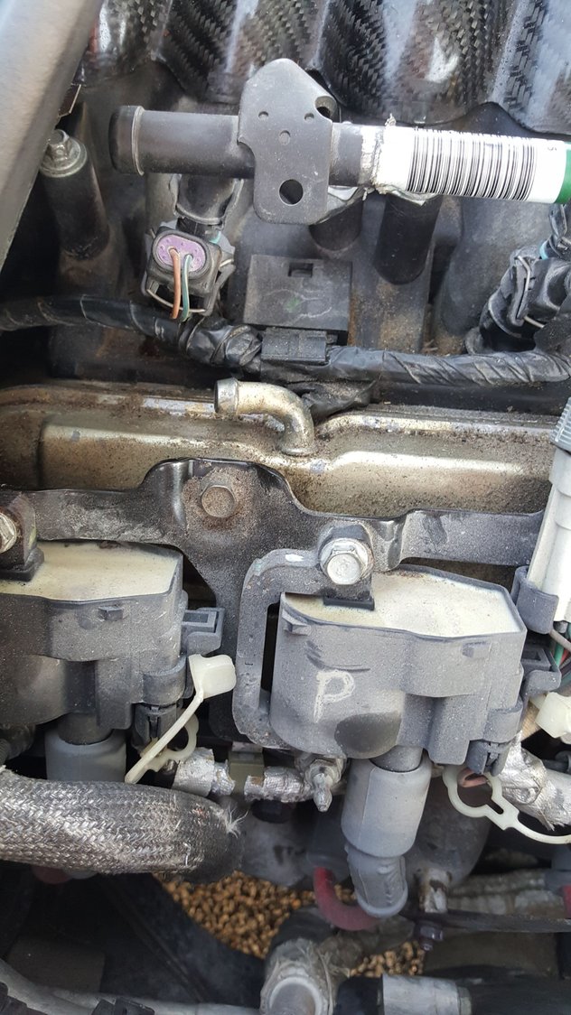

Update! I finally got the car running again but I am still suspicious... The other day I unhooked the battery and removed the throttle body as well as the intake and inspected the connections on the sensors and checked for any vacuum leaks. I found some oil residue in the throttle body and cleaned it out along with the MAF sensor too. I put it all back together and drained out the oil catch can. I did notice that I didnt have a PCV valve and that there is a whistling from the other hose connection (towards the back of the engine). It seems the previous owner did a PCV delete when they installed and I didnt notice until now. Ill post a picture of it. After I got everything cleaned up and put together I hooked the battery back up and she started right up. I checked the Voltage drop between the battery and the Throttle control fuse 17 and showed 0.01V a couple times and 0.00V a few other tests. As the car was running the idle still fluctuated but I didnt have any codes. Disconnecting the battery reset them, but I have started the car about 6-7 times now and even drove it up the block and back. The idle still wants to act up and dropped low enough on me and almost stalled out when I was in gear downshifting to 1st or neutral to a stop sign. I got in today and did the voltage drop again and still the same, and no new codes. I gave the throttle a couple quick blips but even as I got off the gas it held its RPMs around 2000 before settling even after my foot was no longer on the gas. Could that missing PCV connection and the PCV itself be part of the cause? Or would the TAC module still be accountable?
Old Mar 26, 2019 | 10:51 PM
Ozwald25's Avatar
Ozwald25
Joined: Mar 2018
Posts: 20
From: Little Rock, Arkansas
Old Mar 27, 2019 | 10:25 AM

Without the PCV system installed the catch can is really not required now...Is the top hose of the catch can plugged now ??...I would make sure the catch can is tightly secured so you don't have a vacuum leak....as far as the idle issue since you disconnected the battery you might have to do an "idle learn" procedure.

Old Mar 27, 2019 | 06:11 PM
jim993's Avatar
jim993
Joined: Sep 2009
Posts: 1,862
Likes: 594
From: Prescott, Arizona
That looks like a big vacuum leak, no pcv valve, manifold vacuum directly to the valve cover and an open hose fitting on the same valve cover to the rear. Is there an open hose fitting on the other valve cover?
It will run better with the rear hose fitting on the valve cover(s?) plugged, but in my view, you need a hose to the opposite valve cover and a pcv valve.
Old Mar 27, 2019 | 06:19 PM
C5 Diag's Avatar
C5 Diag
Moderator, Tech Contributor
Posts: 15,595
Likes: 4,055
From: Cape Coral, Florida
Hey Jim !!...that hose is on the front of the TB...that’s the fresh air source for the PCV system...no vacuum there...the rear ones on either side tie in together and go to the PCV and that goes to vacuum...PCV is actually a metered vacuum leak...LOL !!
