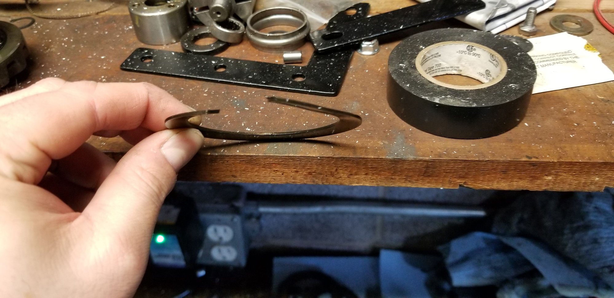

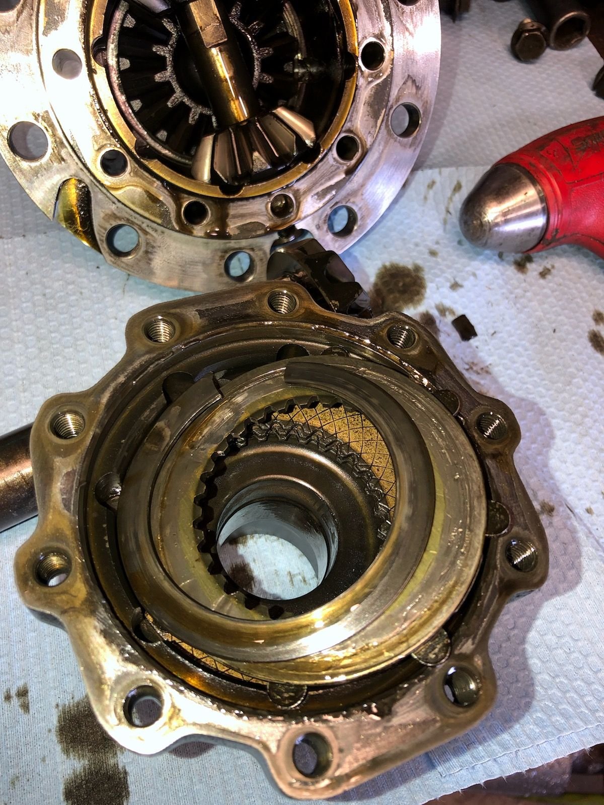

So just to update everyone.. I purchased 2 new C6Z clutch packs as well as 2 new C6Z HD Belleville springs. Dropped the diff off to my buddy who had a 25-30k mile diff from our friend's C6Z. He swapped out the clutch packs, springs, and all the gears/shafts from the C6Z diff. Below are some pictures of the bad stuff that came out.. You will notice the incredibly uneven wear on the clutch discs from the springs breaking and deforming.
Bill, thanks for the help on this one!! Car is going to feel brand new I bet haha

Why the HELL can't GM build something right the first time. Seems like every model update or earlier they improve things like Transaxle parts and make them a little stronger because it wasn't right in the first place. To me that's a false economy to do nickel and dime improvements all the time. Porchea came out with the G-50 Transaxle in late 85 and it was supposed to hold 600 HP and it was a long time before they ever got close to that. GM could have given us a 2008 Z06 style transaxle and clutch in the 1997 Corvette.

Replacing all gears and shafts should have definitely disturbed the differential setup. Did you guys followed the procedures to correctly set it up again?

With that much churned up metal in the diff, I would definitely replace the gear set and all the bearings. Those chunks are hardened spring steel (from the belleville washer) that don't just get flattened out when they pass through the gear mesh. When they get caught between the teeth of the gears, it will slightly deform the differential carrier moving the gear set out of position and causing whine. Often times this can crack the diff carrier, so I would inspect it thoroughly for cracks before reusing it.
There are no cracks in the diff. I check every time it comes out of the car. It has been out more times than I care to count, whether something happened or it just needed to come out for other reasons.
It is all back together and full of brand new amsoil.. ring gear looks good still. Bearings felt good as well, and didn't hang up. Bearings are maybe a year old and I would put my money on the washers being like that for at least a year and a half up to the point of Bill making me aware of this issue/cause.
