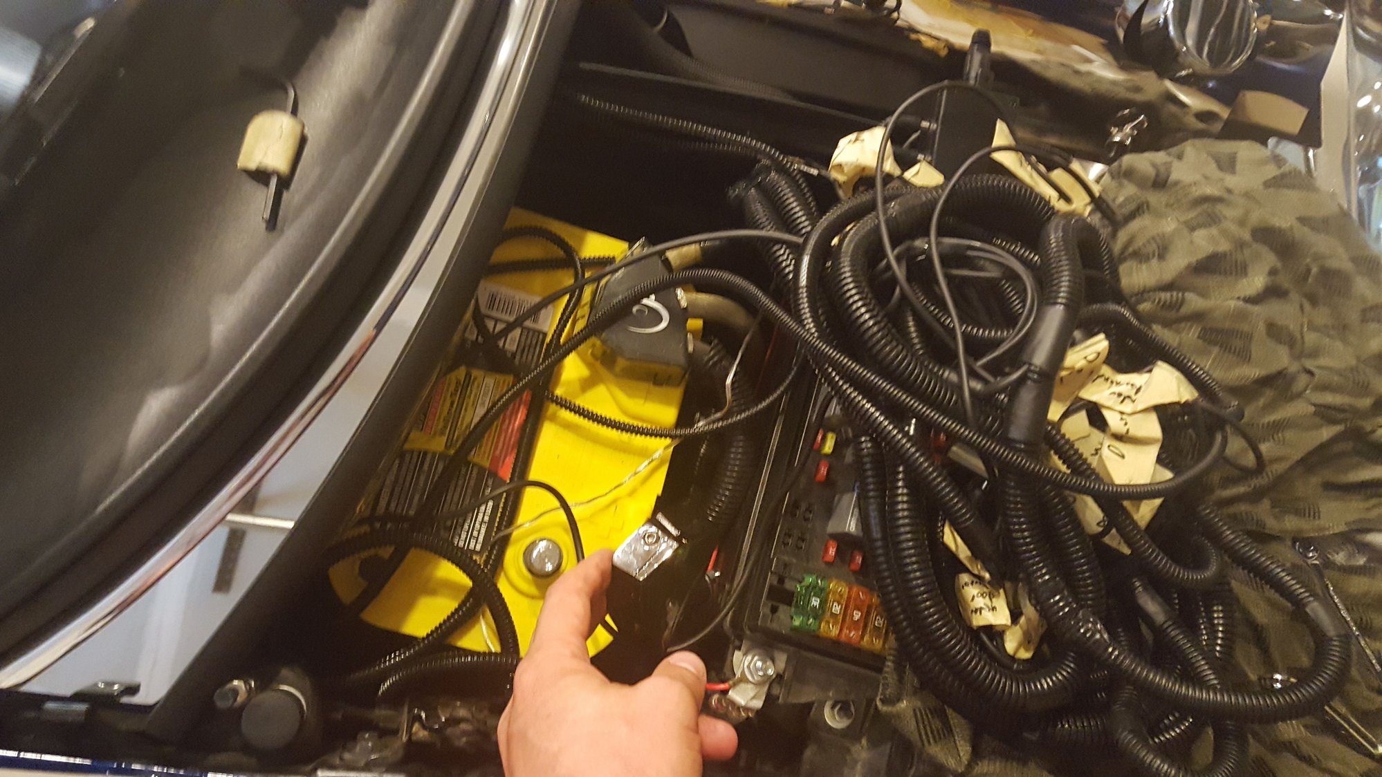

I installed that back in 2003 and while it can get loud, it was set-up for sound quality. Up front is two sets of Infinity Perfect 6.1s which sound spectacular. Total wattage is 1920 watts rms, hence the need for a higher output alternator.
