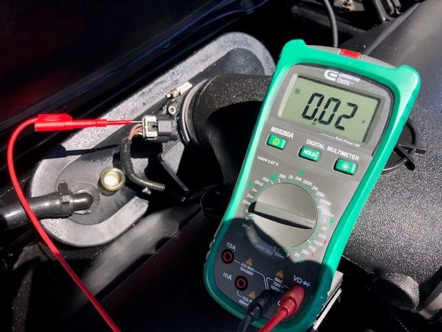

Hei !!
To expand on what Bill said the IAT is a simple 2 wire thermistor...hotter the intake air temp the less resistance and the more voltage you will see with a DVOM...don't know what year but my '01 IAT wire colors are TAN (sensor signal) and purple (low reference-ground)...with the MAF sensor UNPLUGGED and key ON you should see 5 volts on the TAN wire and LESS THAN 100Mv on the purple wire..mine reads .02 volts plugged in...with the connector reinstalled you can see in the picture my voltage on the signal wire is 2.80 volts (intake temp on my scan tool was around 72 degrees Fahrenheit...let me know what you see !!…

To expand on what Bill said the IAT is a simple 2 wire thermistor...hotter the intake air temp the less resistance and the more voltage you will see with a DVOM...don't know what year but my '01 IAT wire colors are TAN (sensor signal) and purple (low reference-ground)...with the MAF sensor UNPLUGGED and key ON you should see 5 volts on the TAN wire and LESS THAN 100Mv on the purple wire..mine reads .02 volts...with the connector reinstalled you can see in the picture my voltage on the signal wire is 2.80 volts (intake temp on my scan tool was around 72 degrees Fahrenheit...let me know what you see !!…

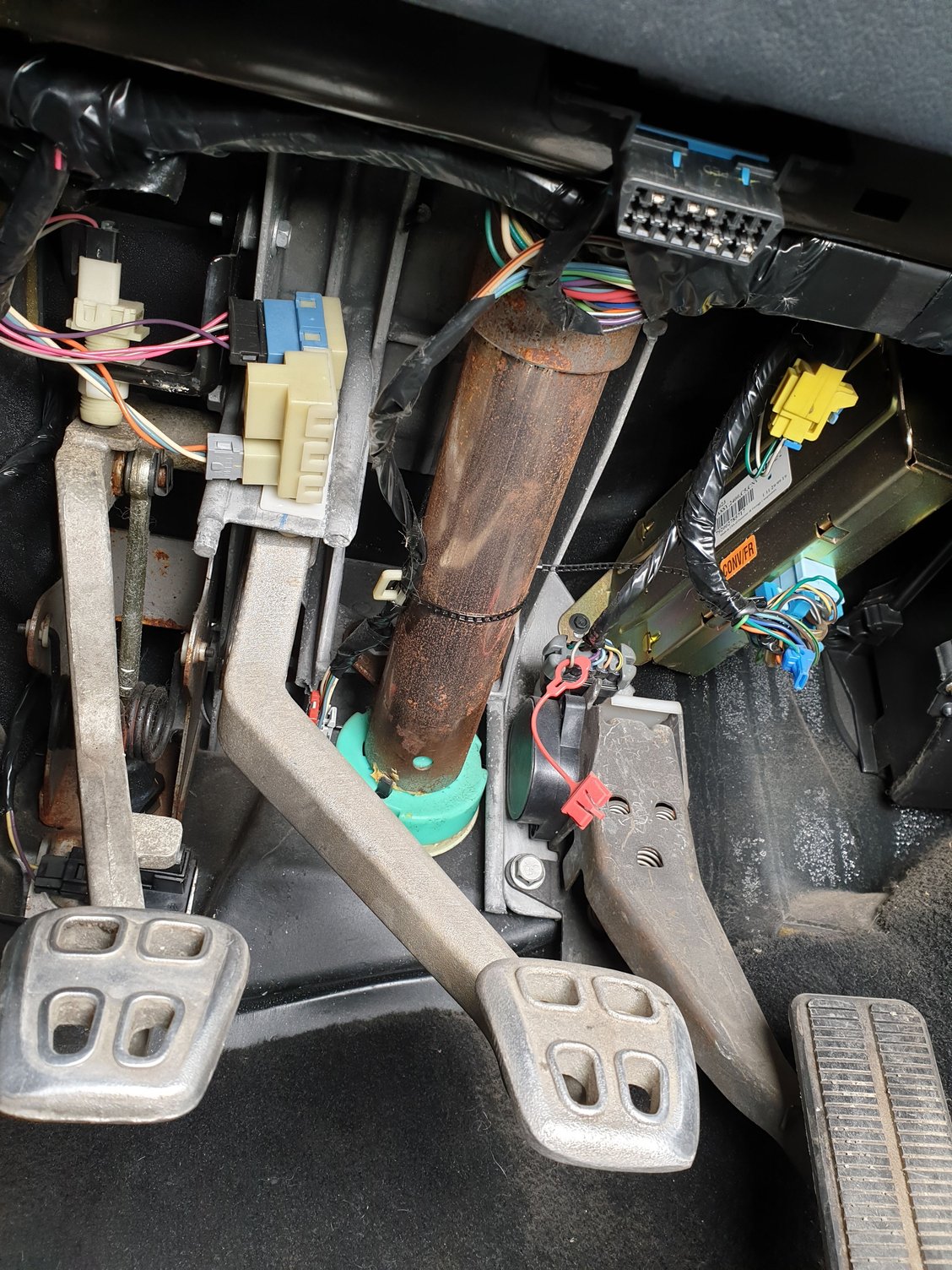

Tryed to look for steering related sensors and found one in foot room, over the pedals. There was connector and it was looking good, not really sure what i was looking for, bill you mentioned pigtails and a connector ? I couldn't understand what it meaned so don't know what to look exactly...

sensor i found is in the picture, green and round lookin on steering column.
