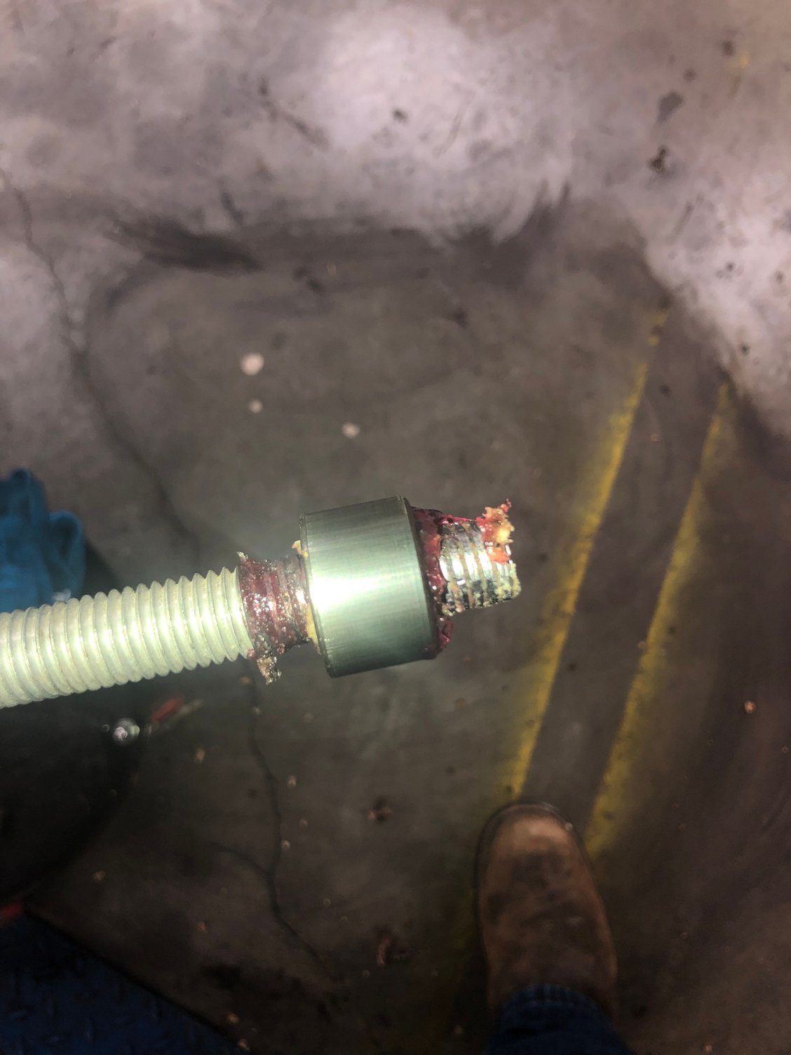

After breaking my Puller and my having my fancy grease gun attachment fail I decided to go old school and grab a piece of bread, all thread and a BF Hammer.
<2 Min and BINGO!!

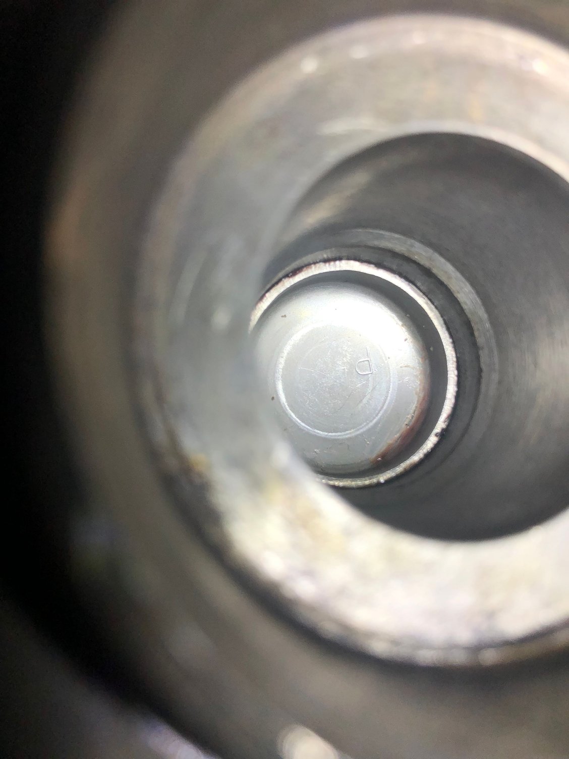

Crap. Decided to post pics. Again I appreciate the feedback. Yes it does have a freeze plug. It appears that I drove it back in approx 1/8”. Is this too much? Do I need to replace? There does not appear to be any leaks but it obviously isn’t under pressure.

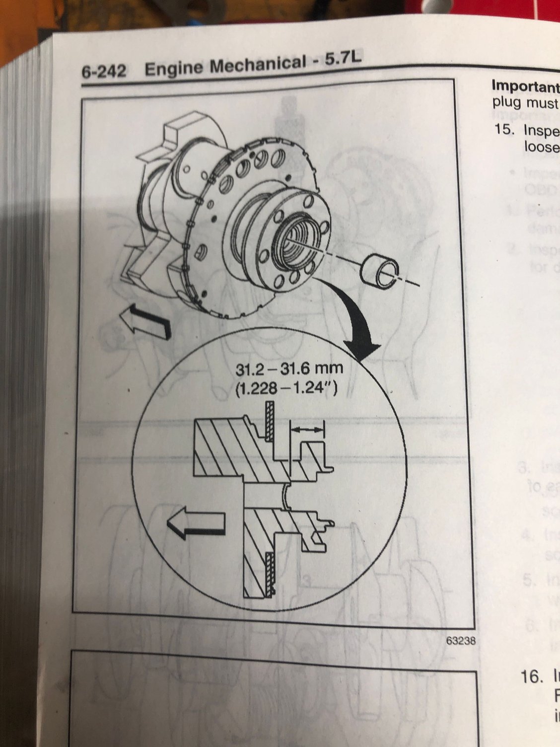

The crankshaft oil gallery plug is supposed to be 1.228-1.24" from the face of the crank (where the flywheel bolt holes are).

Should you replace it? Well....you feeling lucky today?
You are obviously aware of how much work it is to get access to the plug. It'll be much easier to replace it now and have piece of mind then have it leak 100 miles into your clutch break-in. You won't be certain that it isn't gonna leak until you start the car up and run it a bit. Unfortunately....kind of a crap shoot.

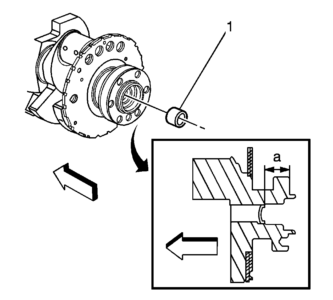

Old Apr 12, 2019 | 01:03 PM

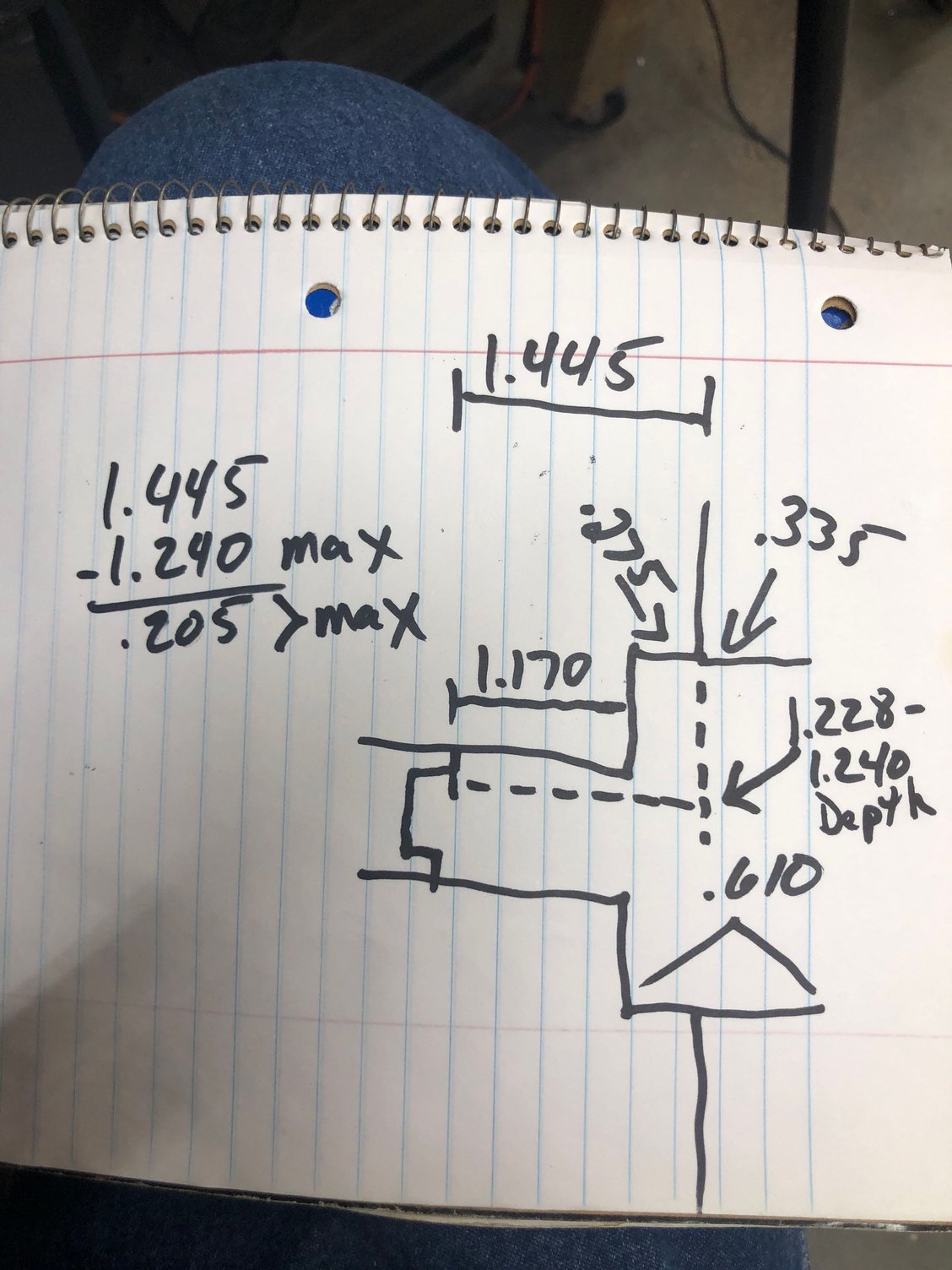

Geesh. Consulted my manual. Apparently the depth is supposed to be 1.228”-1.24” from the face of the crankshaft to the edge of the plug. Mine is 1.170 all the way around from the inside lip that’s easiest to get a solid measurement. So doing a little math it looks like I’m .205” > max. UGH.
Suggestions on removal?

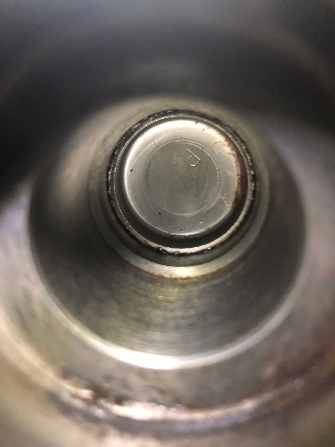

Pulled the old one. Cleaned the internal crank bore. Stabbed in the new $4.97 plug with 242 all the way around to the proper depth.
Good to go!

Emptied oil. Coated a drill bit in Vaseline and put in just small enough hole for my puller hook end to fit through. Put my finger Over the hole and blew the cavity out of shavings. Pulled the stubborn plug. There was minimal amount of shavings behind the plug. Cleaned out remaining bits. Cleaned the bore with brake cleaner dampened rag.
Coated edge of plug in 242. Tried as much as possible to get the plug in straight and to the correct depth. It’s very challenging to get it dead nuts. I was a touch deep .010 but based off the amount of bore that was behind I’m not worried.
