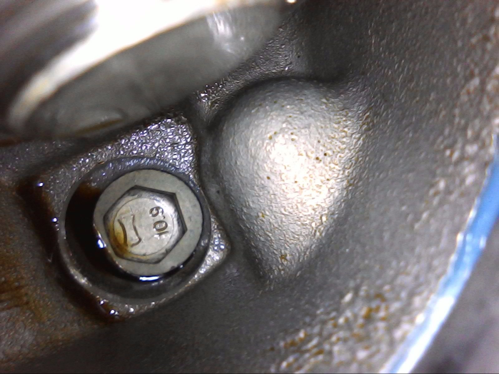

I was able to get a snake camera and see a little of valve springs and rockers. Is the rocker on picture stock? And springs are not yellow. Also, there's a pic of blue valve cover gasket. Did stock car come with blue valve cover gasket? Did i get lucky and previous owner changed springs and rockers? It has 1.7 written on top.

Those dont look like stock rockers to me. Good bet springs changed too, but I would pull a valve cover, its really easy to do. Google the valve spring change, plenty of videos to help you get in there and check. Someone may be able to ID the rockers and springs for you.

LOL!! I AGREE!! Yea,, that was my thoughts too! Rockers look aftermarket! I bet it has a different cam too! Dampener look good to me. I didn't see any appreciable wobble. Like BTTBSS stated,, paint a white line on the FRONT of the assembly across the outer ring, rubber and the hub. If you notice that the white line ever starts to no longer line up, the rubber has become de-bonded from the parts and its time for a new one.

Those rockers look like Yella Terras. Not bad but not top of the line. They aren’t cheap I’ll say that.
I’d consider them a definite bonus in the sale.
The blue vale cover gaskets are Fel-pro. Typical aftermarket no better than GM. You can reuse GM valve cover gaskets countless times.
