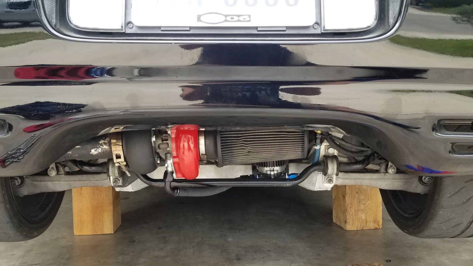

I drove my car last night for the first time with the hotside complete and turbo and oil lines and tested for leaks. I had my manifolds and turbine housing ceramic coated and the whole ypipe wrapped with header wrap and the turbo powered red. The Fuel Pump should come out tomorrow to go to bret for a custom intank sys then to his place few weeks after for the tune.

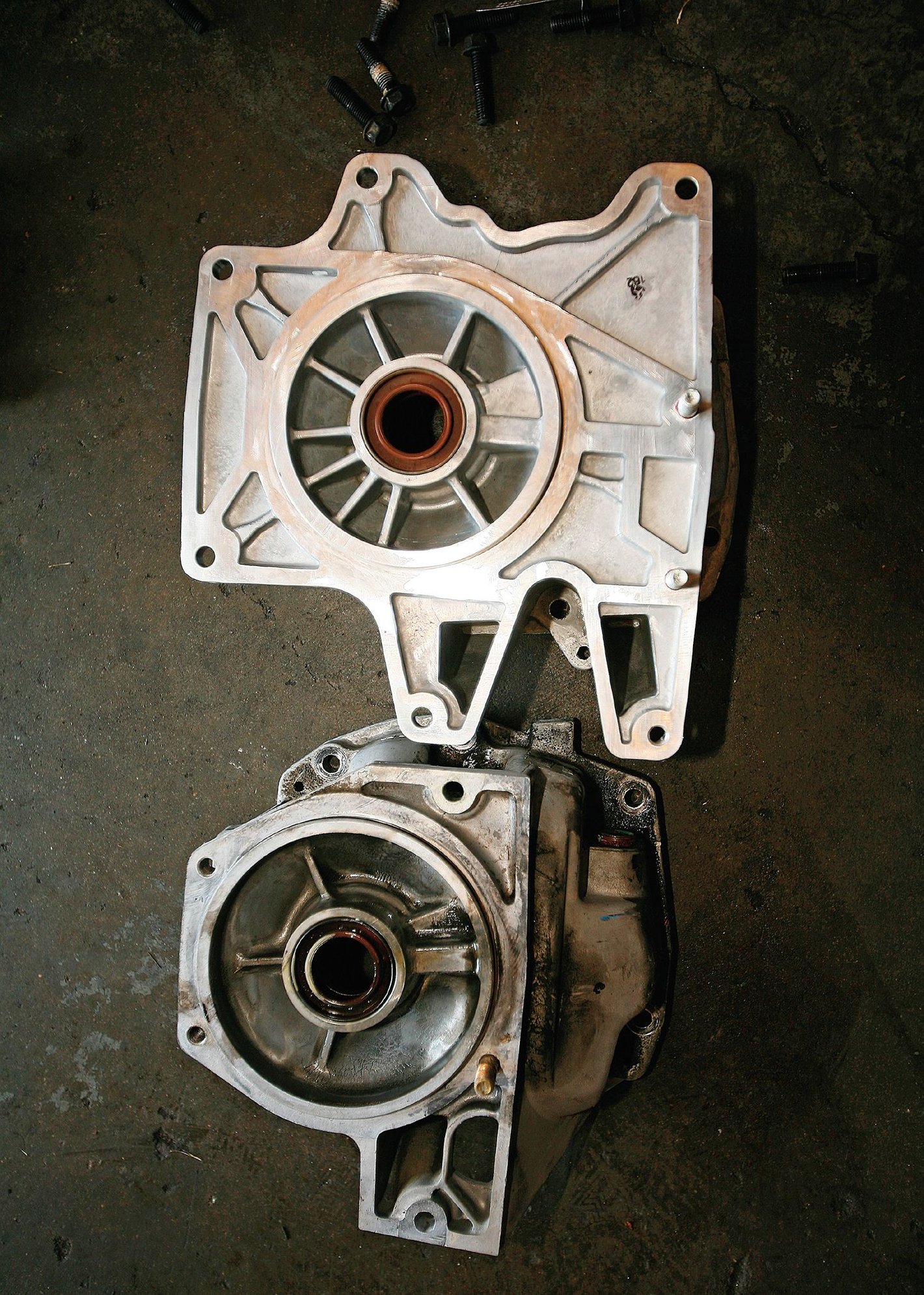

Here are some pics of the c5 vs c6 tailhousing to diff mount and pics of a c6 vs c5diff. You should be able to see why i suggest the c6 diff vs anything else. c5<c6<c6z,zr1
5 vs 8 bolds

I love the turbo setup! That's pretty wicked. What are the turbo specs?

I could be wrong but my total understanding from a tr6060 to m12 c5z t56 is the physical size of the gears. But they both use triple cone syncros.

Everything that I've read up suggests that the t56 ran dual synchros, but I'm not an expert in these.
