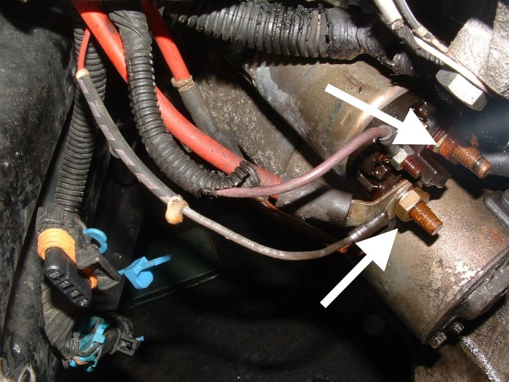

If you just want to see if the starter itself will operate just jump B+ (BIG red wire) at the solenoid to the starter stud (picture below)...just be careful under there...neutral/park, e-brake set, wheels chocked !!...jumping directly to the starter will draw a LOT of current and arcing so a very heavy wire will be required !!...with a 12 volt test light you should have 12 volts on the PURPLE wire when cranking...if it lights the solenoid will be the connection between the B+ wire and the starter !!... if you don't you have to work your way back up the starting circuit !!...to check starter ground connect 12 volt test light to battery NEGATIVE and while cranking the test light should NOT light when touching test light to the starter housing !!

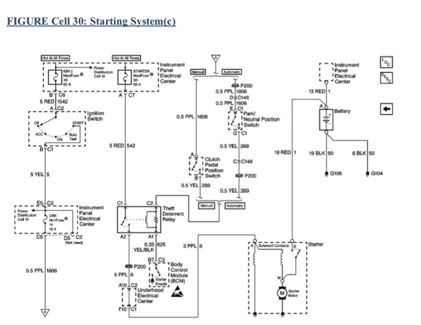

Here is you starter schematic
