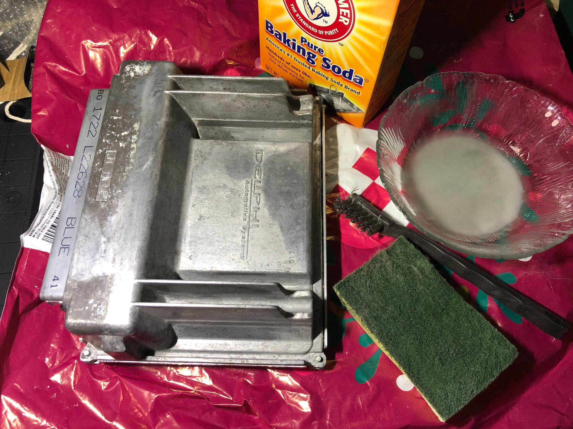

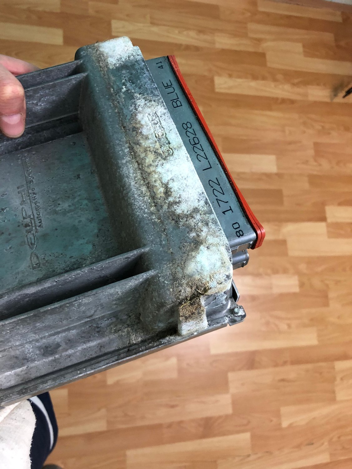

What would be the best way to clean and prevent this?
wire brush and baking soda mix did take most of it off but not the remaining corrosion.... any ideas?

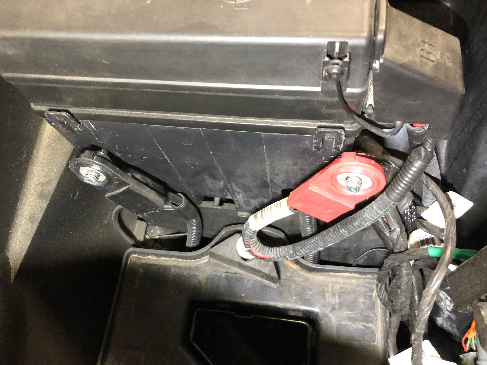

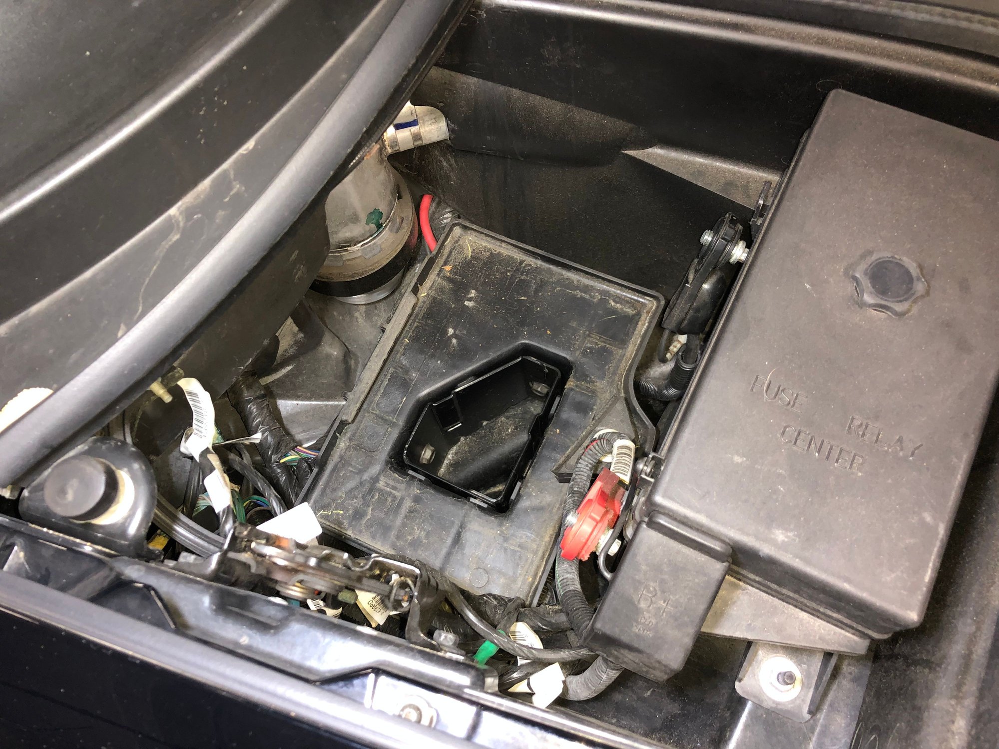

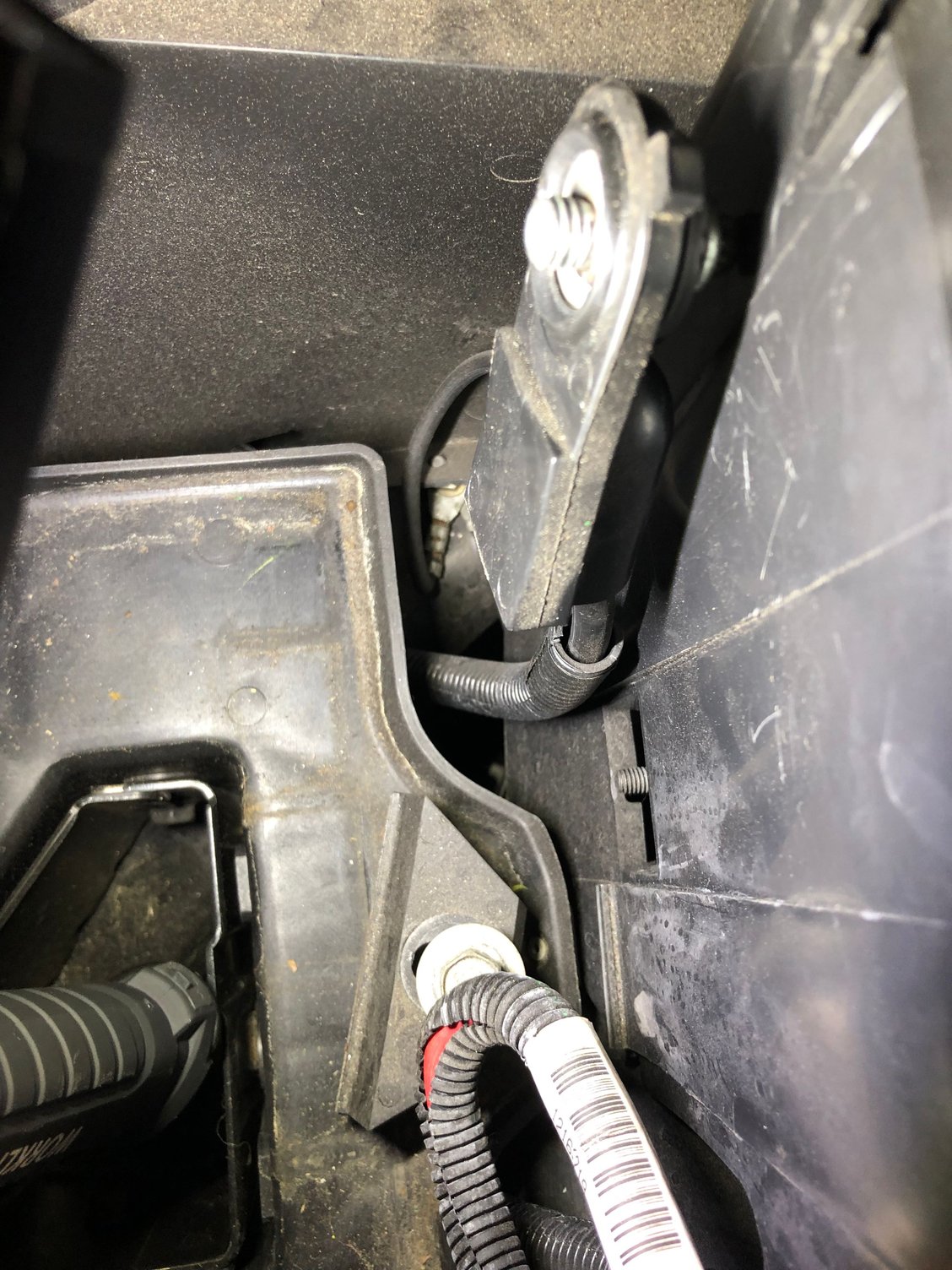

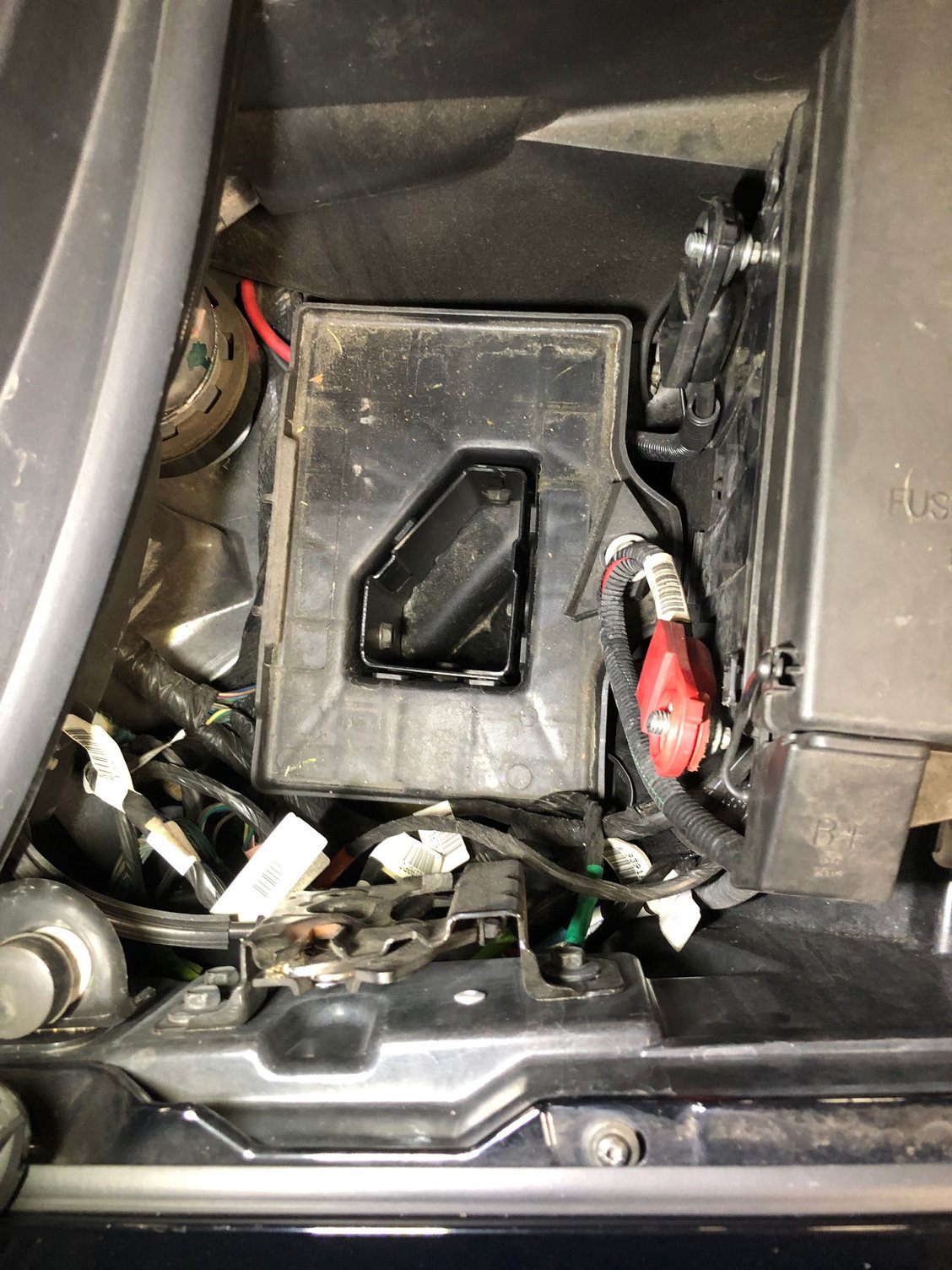

Bill, much appreciated!
Not sure if this is acid or salt.... the car came from Vermont and i know they have heavy snow up there.
The battery location doesn't show any hard acid residue.... mostly around the pcm and bcm
i purchases some wire brush and CRC battery cleaner
https://www.amazon.com/gp/product/B000CIRTY0/ref=ox_sc_act_title_3?smid=ATVPDKIKX0DER&psc=1 https://www.amazon.com/gp/product/B000CIRTY0/ref=ox_sc_act_title_3?smid=ATVPDKIKX0DER&psc=1
will get to work soon and send some updates. see the pics below as it currently stands. If you have any other recommendations please share.

LOL! Your area under the battery really looks pretty good. SO, you escaped the dreaded rip everything out and preserve everything issue. If you see any rust, it should be pretty easy to spot re-preserve it.
Looks like that PCM was salt corroded. The little black box isn't the BCM. Its the Throttle Actuation Control (TAC) module. The BCM is in the passengers foot well behind the toe board next to the fuse box.
Bill
