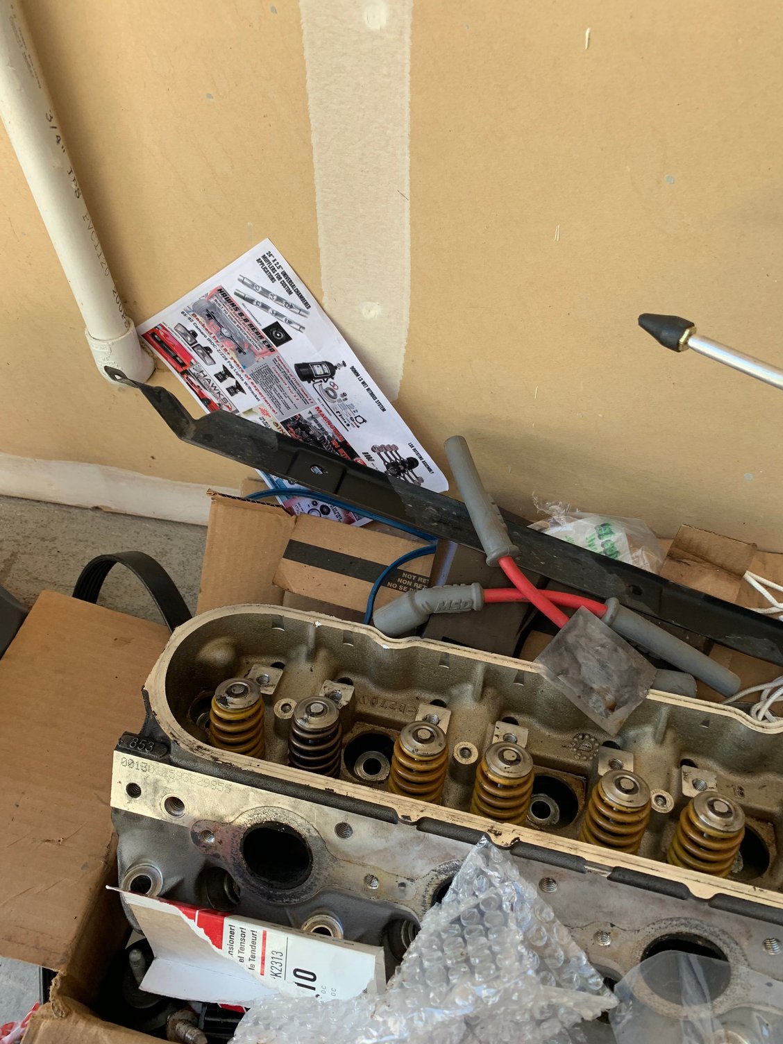

Here’s a example of what you prob should have for springs. Notice one is new but if you look up the part # they will be blue color

Looks like the PAC 1219 springs are for cams under 230 duration and rated to .625 lift so maybe these would be better for my 228R than the dual .660 springs I have. If I swap to these I may try a different pushrod also to experiment with preload. If I run any longer I would be maxed out on preload so I would prob try a 7.375 pr

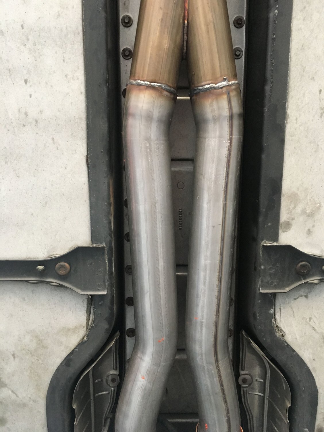

Bwill, did you ever check your entire exhaust to see if you weren’t having direct contact with the tunnel of the car? I just fixed my midpipe today at the muffler shop and my valvetrain noise in the cabin is now gone. No more sewing machine. Worth checking.
New mid pipe segment welded, no more direct contact with the tunnel

Glad you got yours fixed! Yes I did check the exhaust and it’s not touching the tunnel anywhere unfortunately. I didn’t suspect that to be the issue cause you can clearly hear in the cabin that the noise is coming from the motor. I am going to put some shorter pushrods (factory ones actually) in to see if a little less preload makes any difference at all.
