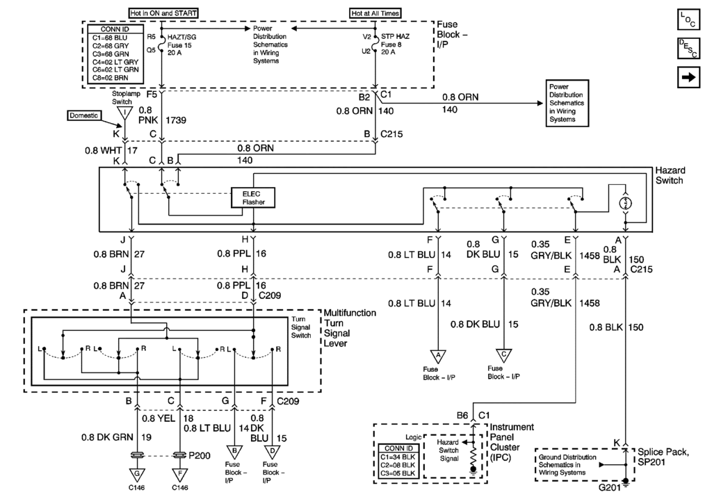

The only way (at least that I can see) that the hazard switch would be able to effect the engine would be because theres a part of the circuit that gets power from the IGNITION SWITCH (hot in run and start). If the things that are powered dray more current than the dirty/defective ignition switch contacts can provide, YES, it would cause other critical engine sensors to start to fail.
Here's a schematic for you.
Look at what the "hot in run and start" (Fuse 15) supplied powers LIGHTING!. That would be enough to draw that current/voltage to cause an issue:
If it were ME, I would replace or service the ignition switch!!

So if that is what is wrong why can i drive my car with the fuse 8 and 15 pulled? Bottom right shows the grounds are shared. One ground in a power distribution system will take voltage away from all circuits.
James,, Just try it with fuse 8 and fuse 15 pulled separate. Anytime they are ON, they draw more current from the ignition switch circuit. Sounds like your switch is compromised and cant take much of a load before it cant supply enough voltage in critical circuits.
